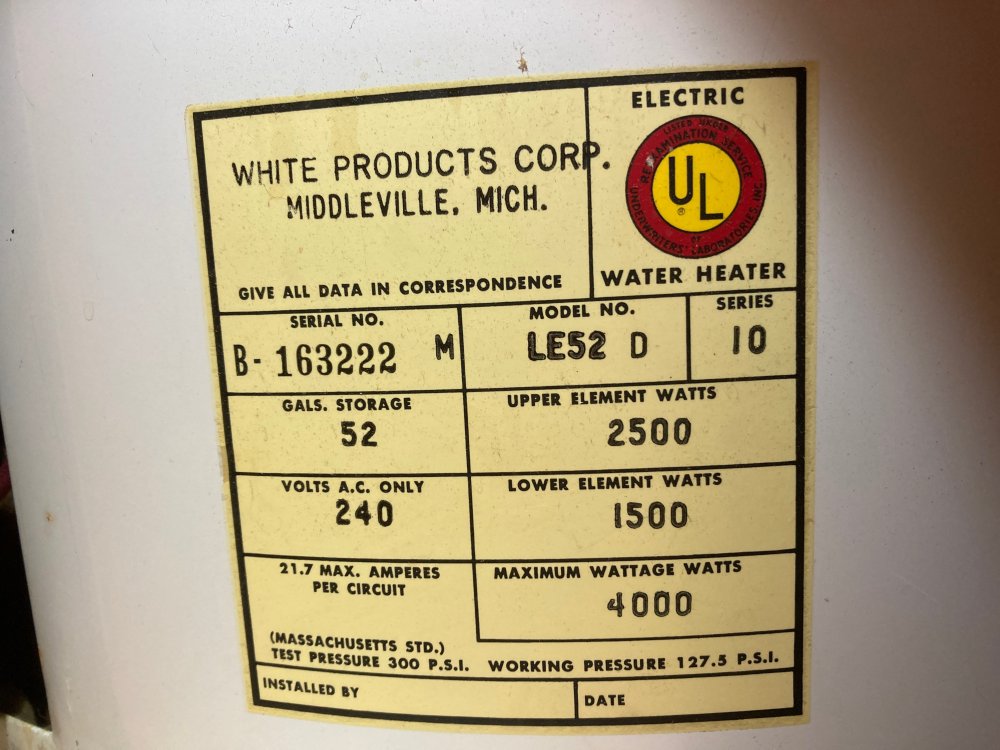

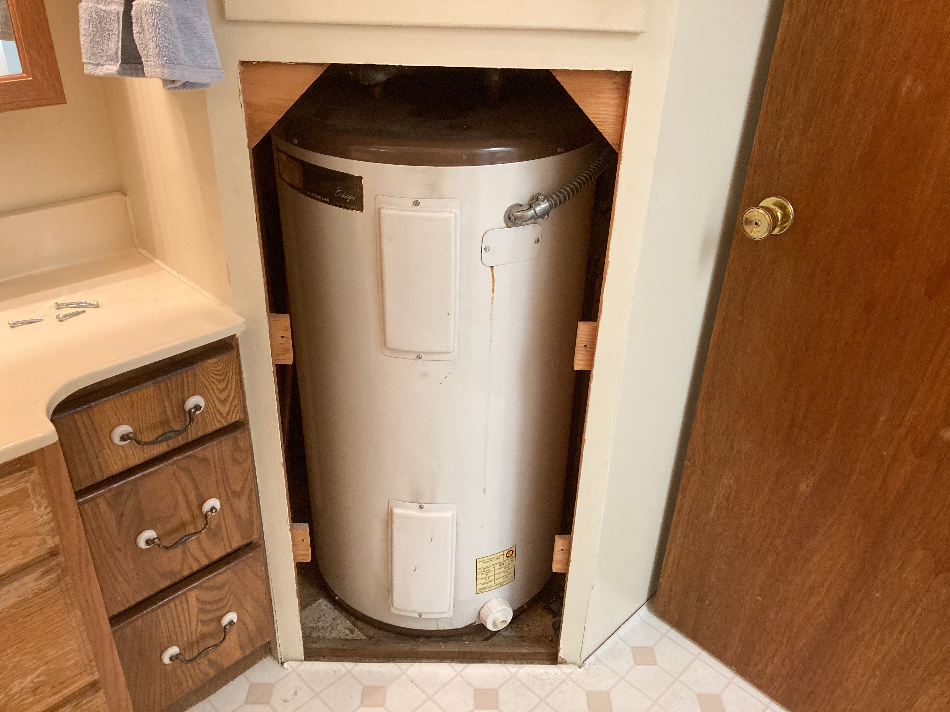

CNewhouse Posted May 19, 2021 Report Share Posted May 19, 2021 Saw this beauty in a 1964 ranch today. Based on what I've been able to find online, it seems White Products Corp was a precursor to Bradford White? Any ideas as to the age of this bad boy? Still working, delivering 130 degree water to fixtures, though the tank is corroded and dripping significantly from the TPRV discharge piping. Link to comment Share on other sites More sharing options...
Jim Katen Posted May 20, 2021 Report Share Posted May 20, 2021 I can't recall having ever seen one. It looks like both elements fire at once - a poor design that will heat the water slowly. Link to comment Share on other sites More sharing options...
Bill Kibbel Posted May 20, 2021 Report Share Posted May 20, 2021 Bradford started out manufacturing coal-fired range boilers in the early 1880s . They merged with White in the late 1960s. That water heater is probably from around 1960. Link to comment Share on other sites More sharing options...
CNewhouse Posted May 20, 2021 Author Report Share Posted May 20, 2021 17 hours ago, Bill Kibbel said: Bradford started out manufacturing coal-fired range boilers in the early 1880s . They merged with White in the late 1960s. That water heater is probably from around 1960. I was wondering if it was original to the home, but had never seen a 57 year old water heater. Didn't realize it was possible. Pretty cool. Link to comment Share on other sites More sharing options...
