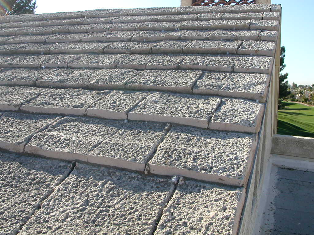

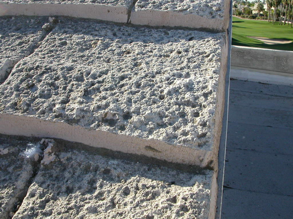

JEuriech Posted March 12, 2006 Report Share Posted March 12, 2006 Last week I inspected a 1984 townhouse with a different type of roof that I am not familiar with. From the ground it appeared to be maybe a 2" concrete tile roof. However, once I climbed up on the roof it turned out to be a foam roof with some sort of hard crusty surface. It looked like all one unit instead of individual pieces. Like maybe they sprayed the foam and then somehow made the impression of the tile afterwards. Before I left, I talked with the neighbor next door. He told me that it was a Bermuda Roof. A foam roof with a hard mortar surface. He also said that most of the roofs in the area have had leakage problems and needed to be sealed. The buyer of the townhouse called me later in the day and told me that they had canceled the contract due to all the issues found in the inspection. Now I am currently doing some research on this type of roof so that I am better prepared in the future. Can anyone tell me how this roof is installed or where I might be able to find information on it? Thanks, Jeff Euriech Peoria, AZ Download Attachment: Bermuda Roof 1.jpg 192.44 KB Download Attachment: Bermuda Roof 2.jpg 210.67 KB Link to comment Share on other sites More sharing options...
mwg27 Posted March 12, 2006 Report Share Posted March 12, 2006 It just Looks like it would leak! [:-bigeyes Link to comment Share on other sites More sharing options...
hausdok Posted March 12, 2006 Report Share Posted March 12, 2006 I can understand why they call it a Bermuda roof. The outward appearance of the roof makes it look like one of those roofs in Bermuda that consist of limestone slates lain out on the roof. I once saw them do a segment on them on the This Old House show. I suppose using foam and sprayed grout to simulate one of these makes a nice looking roof, but I'd never install one without complete coverage beneath the surface from eaves to ridge with a layer of ice and water shield. ONE TEAM - ONE FIGHT!!! Mike Link to comment Share on other sites More sharing options...
