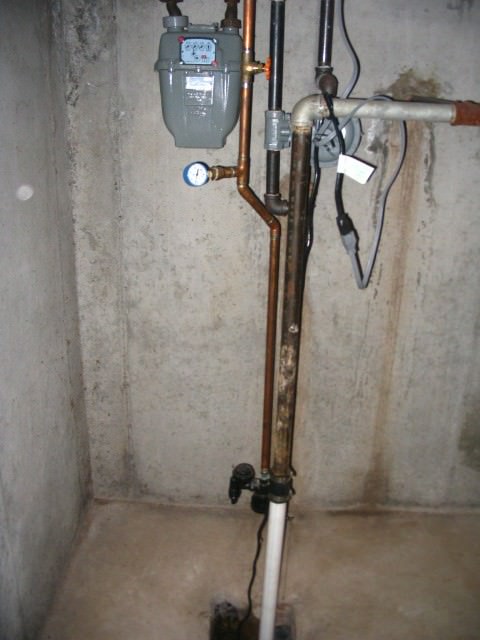

dtontarski Posted April 19, 2006 Report Share Posted April 19, 2006 I ran across this set-up in an inspection yesterday. (see photo). There is a copper water supply line (with a water pressure guage) that terminates in a black plastic device suspended over the some crock. This black plastic device has a ballast that drops down into the sump crock. The black plastic device has a nipple for a hose connection, but nothing terminated on it. Could someone help me define what this is and its intended purpose and functionality? Thanks. Download Attachment: Water Supply Line New Sump Crock.jpg 70.84 KB Quote Link to comment Share on other sites More sharing options...
Bill Kibbel Posted April 19, 2006 Report Share Posted April 19, 2006 It's probably a water powered back-up pump. If it's on a municipal water supply and there's a power failure, the water pressure will create a pumping action. Quote Link to comment Share on other sites More sharing options...
dtontarski Posted April 19, 2006 Author Report Share Posted April 19, 2006 Bill - So what you are saying is that - providing there is a hose attached to the now empty nipple, this would act as a back up sump pump? I guess I didn't inspect this close enough. It seems like there would have to be both an input and output nipple on this pump. One to take in water from the crock and then a hose to discharge the water out from the home. Am I following you? Quote Link to comment Share on other sites More sharing options...
MMustola Posted April 19, 2006 Report Share Posted April 19, 2006 I could not open your picture but what you are describing is a siphon activated back up sump pump. They work very well. City water is sent though a venturi ( just like a duel line jet pump on a well ) creating negative pressure that then pulls the sump water out with the city water. The discharge is usually the same pipe that discharges the primary electric pump. Battery pump with only last a few hours, but as long as the city supply is still pressurized you are in business. Quote Link to comment Share on other sites More sharing options...

Les Posted April 20, 2006 Report Share Posted April 20, 2006 Quite common in Mark's and my world, but I don't usually find an adequate anti-siphon device installed. This would allow contamination of water supply. Your photo looks like only a "part" of the pump is still there. Quote Link to comment Share on other sites More sharing options...
