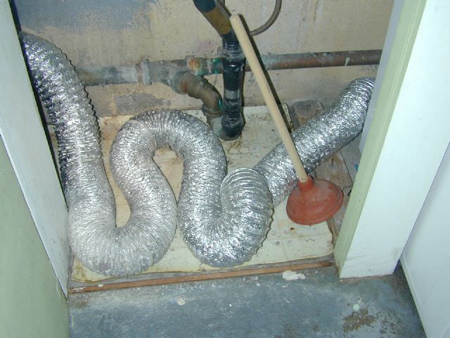

Mike Lamb Posted August 5, 2009 Report Share Posted August 5, 2009 The same code section also specifies that a flexible transition duct shall be listed and labeled in accordance with UL 2158A. Here is a manufacturer of transition duct that conforms. Quietflex I call out foil ducts as bad since I am aware that nearly all of the manufacturer's instructions I have read don't allow them. Click to Enlarge 47.47 KB Quote Link to comment Share on other sites More sharing options...
Kyle Kubs Posted August 8, 2009 Report Share Posted August 8, 2009 So I guess this wouldn't qualify? Click to Enlarge 61.18 KB Or this? Click to Enlarge 27.04 KB What's frightening is I didn't even have to look for these, they were just my last two inspections. And yes, that is a gas dryer with the bathroom exhaust fan vented into it. Quote Link to comment Share on other sites More sharing options...
