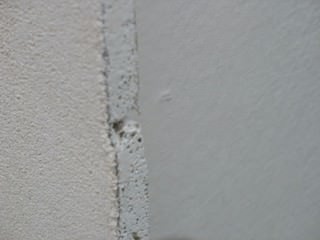

charlieb Posted December 1, 2006 Report Share Posted December 1, 2006 Well here's a new product to me. From a distance it looked like stucco. As the third photo shows it is comprised of panels. I need to read up on it. Any suggestions on what it may be? Download Attachment: a128.JPG 16.62 KB Download Attachment: a129.JPG 19.85 KB Download Attachment: a138.JPG 25.13 KB Quote Link to comment Share on other sites More sharing options...
Bill Kibbel Posted December 1, 2006 Report Share Posted December 1, 2006 I saw something similar on an addition not too long ago. I did some limited research and found it to be synthetic stucco over fiber-cement panels. I also found that there are "cementitious SIPs", aka fiber-cement faced structural insulated panels, often finished with synthetic stucco. Quote Link to comment Share on other sites More sharing options...

kurt Posted December 1, 2006 Report Share Posted December 1, 2006 I think they're synthetic stucco on "durock" substrate. I have a hippie organic farmer friend that's building his wonder energy efficient house w/SIP's that are faced w/durock & stucco. Kibbel's the historic guru; I just look @ old stuff (80-120 yrs). I watch, read, research, & wait humbly in the wings for my chances w/ the historic stuff. Every once in a while I get lucky. Chicago burned to nothing in 1871. Not much is older than 130, but there's a LOT of stuff that's >100, and whole big bunches of stuff built by the truly last gasp of real old world craftsman. I'm real lucky to be doing this thing we do in Chicago; it's a textbook of extinct 19th & 20th century building practices. Quote Link to comment Share on other sites More sharing options...

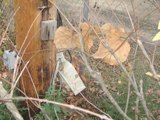

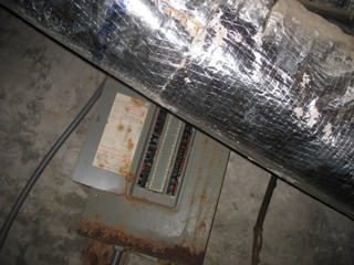

charlieb Posted December 1, 2006 Author Report Share Posted December 1, 2006 1926 or so they say. "(Georgian) Colonial Revival?" If you say so. I tend to look and gawk at the purdy stuff. Kurt's world is that to me. The "gingerbread stuff" is nice for the details. I stand in awe when looking at the craftmanship and compare it to the modern stuff. In my market if a home is new and selling for 150 up to about 700 they forgit how to miter anything. I'm not kidding. Colonial is well just a cube to me. This home is about 70 miles out from me. The atty buying it has a good pratice but likes the old town square type of life. It sits on a huge lot, tennis court and has a pool. $37sf. yes $37sf. I could only crawl about 30% but lotsa bug buffet and efflorence. 2 Stab-loks and three other poorly done panels. Look carefully at a234. Rural MS always means lots of electrical comments. Download Attachment: a136.JPG 27.94 KB Download Attachment: a154.JPG 34.74 KB Download Attachment: a234.JPG 43.31 KB Quote Link to comment Share on other sites More sharing options...
