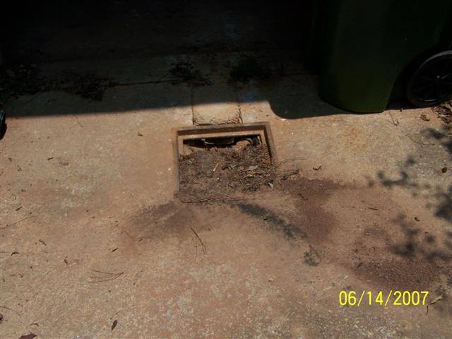

Bob White Posted June 15, 2007 Author Report Share Posted June 15, 2007 Originally posted by Jim Katen Fact: Something in the air reacted with the cooper to cause it to blacken. My Opinion: The cold-water pipes turned black faster because their surface temperature was low and allowed "something" to condense on them. The discoloration may have started as a splotchy pattern, then progressed to complete coverage over time. Query: Was this a crawlspace? Had there been a broken waste line down there in the past? This was an unfinished basement, but it had been humid under there. The driveway led down from the street to the basement garage door, and drainage from the yard also was directed to this drain just in front of the drive-under garage door: Image Insert: 130.97 KB The flue cap was missing (I don't know how long) and the flue was rusted through. The subfloor around the flue was rotted but not wet yesterday (but it hasn't rained much here of late) 70% of the plank subfloor under the half bath was missing (It rotted away over years of neglect) .... There was active leaking (toilet seal, among other things) in the full bath, and the subfloor measured greater than 20% with my Extech over about 100 sq. ft. of subfloor under and around the bathroom area. There's prolly a lot of raw sewage embedded in these subfloors --- might be what's holding up the bathrooms... Quote Link to comment Share on other sites More sharing options...
