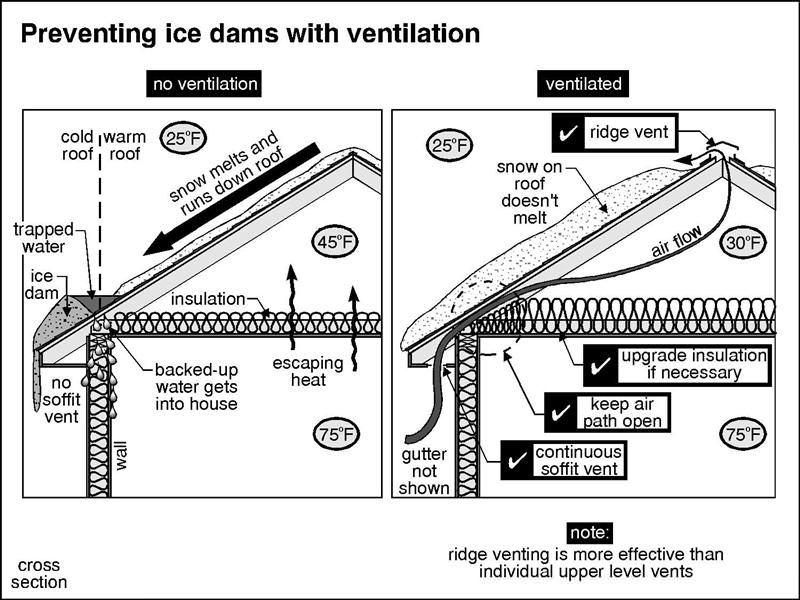

RobC Posted March 25, 2004 Report Share Posted March 25, 2004 Placing insulation underneath the roof sheathing will have a negative effect on the roofing material. It would not only void any guarantee but place the envelope at risk of moisture deterioration. Air, vapour and moisture barrier location and VENTILATION must be considered in the design mix for the system to work properly. Here is something that may apply to your part of the world that typifies good construction detailing regarding ventilation and the prevention of ice daming. Download Attachment: VentilationNIceDam_M.JPG 99.94 KB I can't locate the perm rating for the insulation in question, if anybody out there has that information it would be useful in the discussion. Mark, Maybe you could point me to the research your'e referring to. Quote Link to comment Share on other sites More sharing options...

RobC Posted March 26, 2004 Report Share Posted March 26, 2004 I can see a lenghty debate over the ventilation issue. In the real world of constuction, vapour, weather, and air barriers are never perfect hence you will NEVER find those components operating in absolute values. They both share numerous penetrations that compromise their integrity, and in short, ventilation must be included in the equation to keep the forces of mother nature in balance. Mike, "venting the deck while turning the attic space below it into a conditioned space." That concept would be called converting rafters into ceiling joists and the rules of ventilation apply here as well. I would obtain an endorsment from the AHJ before proceeding in unknown territory. Enclosing a system and expecting it to work according to one's calculations is risky business in my view. Quote Link to comment Share on other sites More sharing options...
hausdok Posted March 26, 2004 Report Share Posted March 26, 2004 RobC wrote: That concept would be called converting rafters into ceiling joists and the rules of ventilation apply here as well.Well, it's not as simple as that. The AHJ may force one to ventilate the ceiling plane, but it's a simple fact that, if the ceiling/roof plane is sealed correctly and moisture can't get into it, ventilation isn't necessary. Some AHJ's will let you get away without ventilating it, if you prove to them that what you're going to do will work. How often does that happen? Almost never. Very few builders take the time to try and reach that degree of air sealing, although Fred Lugano has had excellent success doing just that in Vermont by dense-packing cells into cathedral ceilings and sealing the ceiling plane completely. ONE TEAM - ONE FIGHT!!! Mike Quote Link to comment Share on other sites More sharing options...

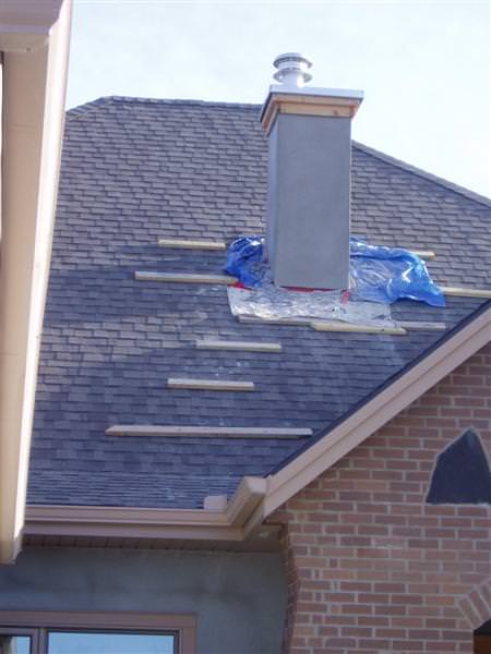

RobC Posted March 26, 2004 Report Share Posted March 26, 2004 The idea is like sticking a sponge underneath the sheathing. One thing for sure, you'd never be able to this: Download Attachment: RoofCleats1_M.jpg 38.79 KB Quote Link to comment Share on other sites More sharing options...
