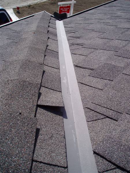

RobC Posted March 26, 2004 Report Share Posted March 26, 2004 A new way to shingle valleys Download Attachment: CaliforniaValley_M.jpg 70.75 KB This ingenious method had to be designed by the guy who developed the plug ins. Quote Link to comment Share on other sites More sharing options...
Chad Fabry Posted March 26, 2004 Report Share Posted March 26, 2004 bet it was fast. Quote Link to comment Share on other sites More sharing options...
hausdok Posted March 26, 2004 Report Share Posted March 26, 2004 Phew, It ain't pretty. However, if the roofer used a full 36inch wide roll of ice and water shield membrane beneath that valley and if that valley flashing is a full 20 inches wide as it should be, it probably won't ever leak. The trick is knowing whether he did or not. That's a lot of ifs. Ouija board anyone? ONE TEAM - ONE FIGHT!!! Mike Quote Link to comment Share on other sites More sharing options...
RobC Posted March 26, 2004 Author Report Share Posted March 26, 2004 This has been going on for the last 2 years and I have just discovered it yesterday. I have a call to the manufacturer's technical support. The roofing association does not allow it but can't really enforce the industry. My quandry is the reporting of this roof as new and my client assuming it's under full warranty when it's not. I wonder if Dr. Phil has an answer? Quote Link to comment Share on other sites More sharing options...
hausdok Posted March 26, 2004 Report Share Posted March 26, 2004 Yeah, It's the same here with the NRCA and ARMA. They strongly recommend drip edging at the rakes and eaves of every asphalt roof, but 98% of the roofers here don't use it. Instead, they extend the first course of shingles about 2 - 2-1/2 inches into the gutter where it will get damaged by joe homeowner as he tries to clean out his gutters and eventually result in rotten edges at about 5% of the houses where the technique is used. Is ice and water shield commonly used up where you are? Seems like it would be, given the extreme temperatures and snows. ONE TEAM - ONE FIGHT!!! Mike Quote Link to comment Share on other sites More sharing options...
RobC Posted March 27, 2004 Author Report Share Posted March 27, 2004 Ice and water shield is used only on custom homes that specify it. When I see it, I go in partial shock for a second, not believing my eyes. Here is something you won't believe, we are the only Province out of ten, maybe the world, that still allows for eave protection...............POLY. Yes, I said the plastic stuff in a roll a.k.a. visqueen. And again the poor consumer gets the stick, no warranty, the manufacturer will void their guarantee on site. As I write this, it gives me the idea of including a construction scam link to my website for people to get the proper advise and avoid common pitfalls. Maybe we should all get together and write a book on the scams we run across. Construction Scams EXPOSED $29.95 plus tax What do ya think? BTW the roofing association calls it a California Valley. Why not! Lets blame the neighbours for our screw ups. Quote Link to comment Share on other sites More sharing options...
