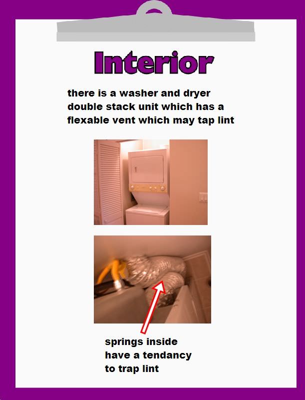

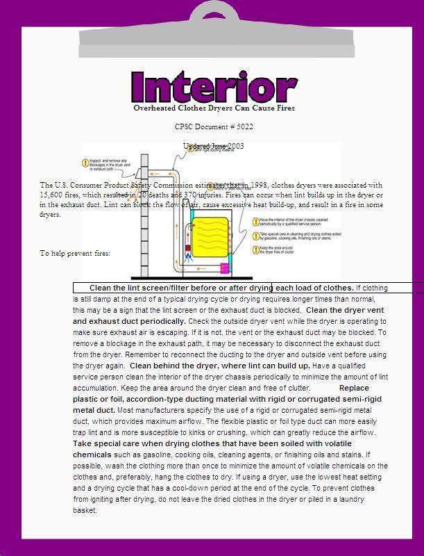

chicago Posted October 24, 2007 Report Share Posted October 24, 2007 Image Insert: 157.03 KB Image Insert: 384 KB What is easy for us is not always easy for an office worker to understand and I feel the above is an example of how pics and illustration help people comprehend. Quote Link to comment Share on other sites More sharing options...

chicago Posted October 24, 2007 Report Share Posted October 24, 2007 Mike ...I notice no comment from a man not at a loss for words. Quote Link to comment Share on other sites More sharing options...
chicago Posted October 24, 2007 Report Share Posted October 24, 2007 WJ I put this as an example of how pics and illustration help for forum purposes. I am the only one to do so for the obvious tear it down with a micro scope reasons. Now if you wish lets all break it down and show how we would have done it correctly. I seem to recall this thread started with the promise of show and tell. Thank goodness I picked an easy subject. Quote Link to comment Share on other sites More sharing options...

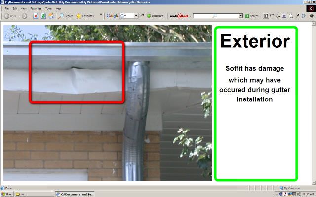

chicago Posted October 24, 2007 Report Share Posted October 24, 2007 You will have fun with this one to. Image Insert: 201.72 KB Quote Link to comment Share on other sites More sharing options...
chicago Posted October 24, 2007 Report Share Posted October 24, 2007 Ha Ha I understand what you are saying but I just threw that together and it is not from anything. The general point I was trying to make is how pics and diagrams help the customer understand. Now I am not picking ,but you make my point in that as inspectors we worry so much about being technical that we forget our audience and the whole reason for the report. I bet at least half (just a guess) of the inspectors would do a more tech correct verbage, and at the same time most of the clients would prefer my version. I think you get my point. I also understand where you are coming from as an experienced inspector. I knew the mis spell would get hit as the jest of the format got lost. Quote Link to comment Share on other sites More sharing options...

hausdok Posted October 24, 2007 Report Share Posted October 24, 2007 Originally posted by chicago Mike ...I notice no comment from a man not at a loss for words. Well, Bob, I was trying to be nice. Sometimes it's better not to say a thing. That's probably why Richard posted what he did. Since you ask, I figured the garish color, tacky clipboard graphic, and confusing crowded page of text over that graphic would make my point for me. Unlike Walter, I didn't bother to proofread it. What's wrong with saying something like: Unsafe accordian-type duct connector: The clothes dryer is being vented with a flexible accordian-type plastic connector from the collar of the appliance to the wall outlet. The Consumer Product Safety Commission (CPSC) has been reporting for years that, unless they're cleaned frequently, accordian-type ducts eventually become clogged with lint and will often catch fire. You can learn more about this on the internet at the CPSC website at this link: http://www.cpsc.gov/CPSCPUB/PUBS/5022.html To correct this, CPSC recommends replacing the accordian-type connector with a smooth-walled metal connector. Replace the connector now and ensure that you clean the entire dryer duct system at least annually. It's boilerplate so I don't have to retype it every time or insert and position a photo for it, it doesn't take up a whole page and, though a picture of the duct might help the to visualize it better, it's easily understood without a photograph. OT - OF!!! M. Quote Link to comment Share on other sites More sharing options...
hausdok Posted October 24, 2007 Report Share Posted October 24, 2007 Originally posted by chicago You will have fun with this one to. Image Insert: 201.72 KB Why couldn't you simply say?: Soffit Damage: At __________, the soffit has been damaged near a downspout and needs to be repaired. Why even bother to voice a theory about what's caused it? It's a pretty cut-and-dried issue, don't you think? There's damage; it should be repaired. OT - OF!!! M. Quote Link to comment Share on other sites More sharing options...

Neal Lewis Posted October 24, 2007 Report Share Posted October 24, 2007 That looks like the fascia to me, and probably just the aluminum trim coil. Quote Link to comment Share on other sites More sharing options...
kurt Posted October 24, 2007 Report Share Posted October 24, 2007 Well, not trying to go all negative, but taking pic's of dryer ducts & taking up a whole page w/really bad narrative isn't what I'm talking about. The purple graphic, by itself, is offensive. (sorry....) In my world, dryer ducts get a quick sentence delineating the hazard, and a hot link to the CPSC article. I might include a pic of the duct if the customer isn't present, but it would be along the lines of "this is the dryer duct I'm talking about". The fascia/soffit dent is different. All of our reports go to an attorney; if I say "the soffit's damaged; fix it", I invariably get a call saying "how bad?". A quick & simple pic let's them make the call on how bad. If I try to qualify "how bad", invariably there's a contractor ready to go the other way. This goes back to what I was saying about learning to work w/pic's effectively; it's real easy to go overboard, and have it all become superfluous. It's why I've developed software that allows me to run pictures any number of ways; I can use a few, a lot, or I can have a whole photolog of everything as visual record of where I was and what I looked @. Quote Link to comment Share on other sites More sharing options...

chicago Posted October 24, 2007 Report Share Posted October 24, 2007 Thank you for the comments ,and I was not expecting any hold back on TIJ. The reason you post here is that you are left brainers and not fans of images. I intently made a graphically loud color comment to show the opposite of a long worded drawn out technical analysis. There is a middle ground. Please note that in the below case a picture does speak for you. Image Insert: 48.66 KB Quote Link to comment Share on other sites More sharing options...
