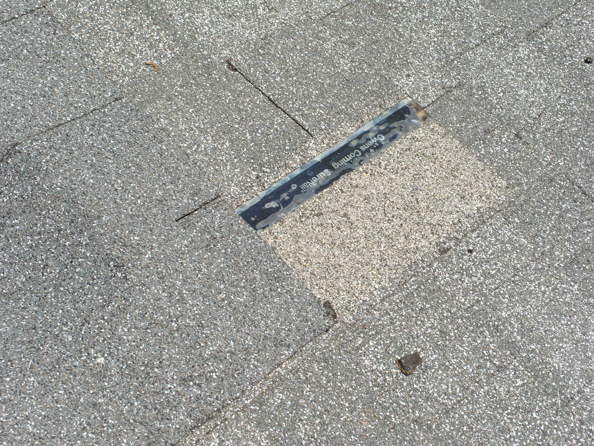

el gato Posted June 25, 2008 Report Share Posted June 25, 2008 I crawled up on a roof the other day and spotted this !!! Image Insert: 796.44 KB Quote Link to comment Share on other sites More sharing options...
hausdok Posted June 25, 2008 Report Share Posted June 25, 2008 Yeah, so? Are telling us or asking us? It's hard to respond when we don't know what you were thinking when you posted the photo. ONE TEAM - ONE FIGHT!!! Mike Quote Link to comment Share on other sites More sharing options...

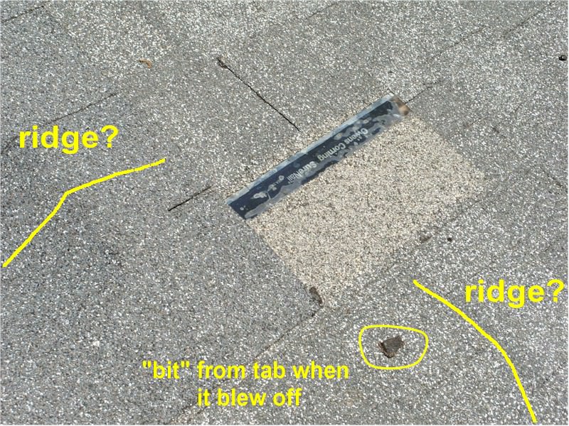

el gato Posted June 25, 2008 Author Report Share Posted June 25, 2008 It appears to me that this shingle was applied upside down. That sealing strip should adhere the the top of the shingle beneath it. correct?? Quote Link to comment Share on other sites More sharing options...
randynavarro Posted June 25, 2008 Report Share Posted June 25, 2008 Oops. Quote Link to comment Share on other sites More sharing options...
Brandon Whitmore Posted June 25, 2008 Report Share Posted June 25, 2008 Got any more pics further back? I am getting a headache staring at this one. It looks like the key holes are running both directions... is this at a valley? I can't think of any application where that installation would be allowed. Quote Link to comment Share on other sites More sharing options...
hausdok Posted June 25, 2008 Report Share Posted June 25, 2008 It looks almost like there are shingle slots aimed toward the center from the upper right, lower left, and lower right, as if it's where peaked roofs meet the slope of a third with a dead-ended valley in the center. Is it? If so, which way does that valley drain - to the upper left of the picture or lower right? OT - OF!!! M. Quote Link to comment Share on other sites More sharing options...
Tom Raymond Posted June 25, 2008 Report Share Posted June 25, 2008 With all those grooves going in all those directions, it's no wonder there's a shingle upside-down. Tom I'm dizzy just looking at it[] Quote Link to comment Share on other sites More sharing options...
Richard Moore Posted June 25, 2008 Report Share Posted June 25, 2008 I might be mistaken, but I seem to be seeing two ridges, with the missing tab in the corner(???). Very odd looking as far the way the shingles have been laid, and I can't quite get my head around that (do we have a wide shot?). However, I'm not sure what is meant by "upside down". It just looks like a tab blew off before the normal adhesive strip on the layer beneath had a chance to stick. Image Insert: 279.45 KB Quote Link to comment Share on other sites More sharing options...
