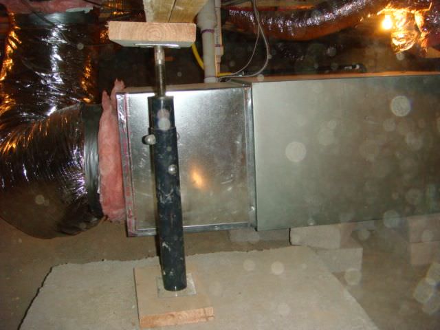

mridgeelk Posted August 19, 2008 Report Share Posted August 19, 2008 Does anyone know the brand name of this post and its rating. It is carrying about 8650# of load per post. There was no ID of any kind on the posts. I did note the flaky installation. And, just for the fun of it a new, at least to me, use for vinyl siding scrap. Image Insert: 122.82 KB Image Insert: 135.09 KB Quote Link to comment Share on other sites More sharing options...
mridgeelk Posted August 19, 2008 Author Report Share Posted August 19, 2008 I just found the posts at Home Depot, they are well within their rating. The clue was that all the exterior doors had 2x4 jambs even though they were set in 2x6 walls. Home Depot sells only 2x4 jambed exterior doors. Quote Link to comment Share on other sites More sharing options...
Bill Kibbel Posted August 19, 2008 Report Share Posted August 19, 2008 I've seen black coated short jacks, with the carriage bolts, manufactured by Akron Products. Was I right? Quote Link to comment Share on other sites More sharing options...
mridgeelk Posted August 19, 2008 Author Report Share Posted August 19, 2008 The Home Depot posts are Tiger brand. It sounds suspiciously Chinese not like from Ohio. Originally posted by inspecthistoric I've seen black coated short jacks, with the carriage bolts, manufactured by Akron Products. Was I right? Quote Link to comment Share on other sites More sharing options...
Mike Lamb Posted August 19, 2008 Report Share Posted August 19, 2008 Tiger Brand is in PA. http://www.tigerbrandjackpost.com/ I have called them before and they were very nice and helpful. That post in your picture can probably carry over 14,000 lbs. Quote Link to comment Share on other sites More sharing options...
Chad Fabry Posted August 19, 2008 Report Share Posted August 19, 2008 Jack posts are not building columns. Quote Link to comment Share on other sites More sharing options...
Tom Raymond Posted August 19, 2008 Report Share Posted August 19, 2008 Originally posted by Chad Fabry Jack posts are not building columns. That explains why they're not anchored top and bottom, they're only temporary[] Tom Quote Link to comment Share on other sites More sharing options...
mridgeelk Posted August 19, 2008 Author Report Share Posted August 19, 2008 I apologize to Tiger for the slam. Originally posted by Mike Lamb Tiger Brand is in PA. http://www.tigerbrandjackpost.com/ I have called them before and they were very nice and helpful. That post in your picture can probably carry over 14,000 lbs. Quote Link to comment Share on other sites More sharing options...
