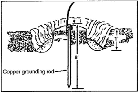

hausdok Posted October 26, 2008 Report Share Posted October 26, 2008 Hi, I'm basically an electrical idiot, so don't mind me if I ask a dumb question; but is it possible that folks just haven't been careful enough about ensuring that all of those grounding rods have less than 25-ohms resistance when they sink them out there? I remember that soil well; it's hard as all get out and there might be stuff there that's allowing too much resistance and is making it real easy for those systems to want to reach out and bite someone. There are usually dozens of generators running in relatively close proximity to one another and I should think that all it would take is one where there's too much resistance in the soil around the rod and you might have a situation where all it takes is a little water on the soil (such as showers) to create a transient and make it reach out and touch someone. The army describes a whole lot of methods to use to improve grounds in their manuals but where soil conditions are so bad that less than 25-ohms resistance can't be achieved, they recommend lowering resistance by chemically treating the soil. Here's the formula right from the Army playbook. c. Treat the soil with chemicals if the ground resistance is still over 25 ohms after using the methods described in paragraphs 1-3a and 1-3b. Treat the soil by- · Digging a circular trench around the grounding electrode. The trench should be 1 foot deep and 9 inches away from the electrode (Figure 1-15). · Filling the trench with 50 to 100 pounds of rock salt (copper sulfate or magnesium sulfate may also be used) and then filling the trench with water. As the water goes through the salt into the ground, resistance should be lowered. Natural rainfall will continue the process, but you must replace the rock salt every two years (Figure 1-16). Figure 1-15. Trench dug around grounding rod Image Insert: 36.8 KB Figure 1-16. Trench filled with rock salt Image Insert: 33.22 KB Quote Link to comment Share on other sites More sharing options...
Jeff Remas Posted November 5, 2008 Report Share Posted November 5, 2008 I am curious as the the grounding requirements due to the type of soil or lack there of (sand) creating a proper ground fault path. <25 Ohms is required between supplemental rods, but I am not sure that is a good benchmark for a primary grounding point. Is Tedesco really going overseas? Quote Link to comment Share on other sites More sharing options...

hausdok Posted November 5, 2008 Report Share Posted November 5, 2008 Originally posted by Jeff Remas I am curious as the the grounding requirements due to the type of soil or lack there of (sand) creating a proper ground fault path. <25 Ohms is required between supplemental rods, but I am not sure that is a good benchmark for a primary grounding point. Is Tedesco really going overseas? That's a huge misconception. The "sand" is only a few inches deep except for where it's drifted. Once you get below the sand in Kuwait, Saudi or Iraq you hit some of the hardest sh*t you'll ever try to dig through. Before the air force bombardment phase of DS kicked off, command ordered us to dig bunkers. What a friggin joke! I had nearly 30 guys working round the clock in shifts with picks and shovels to dig a 10 by 16ft. bunker and after 24-hours they'd barely made 18-inches. I finally drove out onto the desert, found 4 brand new latrines that hadn't been used yet, loaded them up on a couple of HMMV trailers, brought them back, stripped two sides off of each of them, and then set them into that hole, leveled them, and stacked sand-filled 55-gallon drums all around that sucker, reinforced the roof and then put on a 3-layer sandbag blast cushion roof. Just as we got it done, Brigade HQ comes down and says that they're going to commandeer it for the secondary HQ in the event of an attack. Yeah right, you should have seen the looks on their faces the morning of the offensive when some panicky twit yelled "gas!" and the entire brigade had to suit up and get in bunkers. They walked up to find my platoon solidly entrenched in there and there was no way they were going to come out and let a bunch of remfs take their bunker. Anyway, I digress; the "soil" there is very hard strata and it's laced with some kind of light-colored mineral that looks almost like chalk but is hard. Driving ground rods into the stuff is a b***h. You have to try multiple locations in order to find a spot soft enough where you can get the rod to any depth, so you mostly scrape out a trench, lay the rods lengthwise and then bury them. I think they need to look at the soil composition and how poorly those grounding electrodes are probably being installed. ONE TEAM - ONE FIGHT!!! Mike Quote Link to comment Share on other sites More sharing options...
