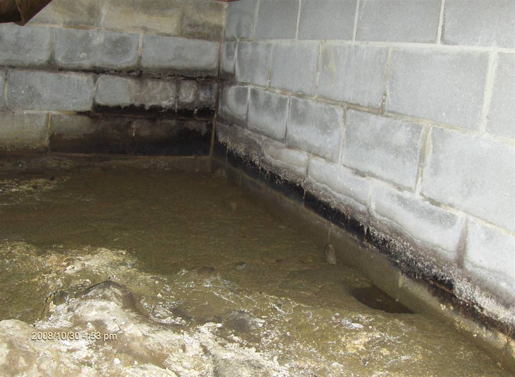

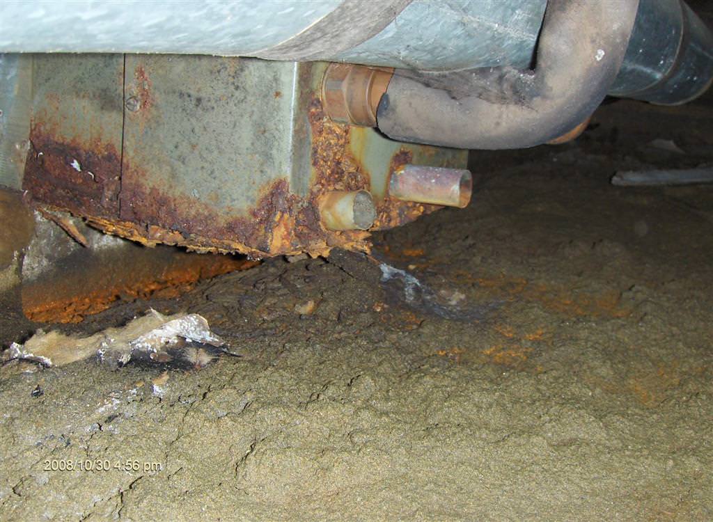

John Dirks Jr Posted October 31, 2008 Report Posted October 31, 2008 What type of professional do you recommend for a situation like this? You can see the pooling water next to the wall. The surrounding area is very wet and mushy. There was a perforated extension tube for a downspout just above this area outside. I'm sure that doesnt help matters. Neither does the lack of condensate drain lines from the rusting air handler. Image Insert: 135.68 KB Image Insert: 160.91 KB
kurt Posted October 31, 2008 Report Posted October 31, 2008 I would recommend a really good home inspector. There isn't any particular trade that is going to come in and see all the interconnected variables. The bsmt. waterproofing guy is going to sell drain tile, the heating guy is going to sell heating equipment, the landscaper is going to sell them bushes, etc., etc...... I would like to see the profession progress to the point where folks were competent to craft descriptions and solutions for this sort of mess.
Mike Lamb Posted October 31, 2008 Report Posted October 31, 2008 To stop the moisture, I'd recommend a good water proofer. They are not all crooks. Stop the water if that's possible although CMU can be a tough nut, and then fix the other stuff.

John Dirks Jr Posted October 31, 2008 Author Report Posted October 31, 2008 I'll be making recommendations to various professions to fix things that could lead to this. I was not specific enough. I meant to ask about who to recommend to deal with the fact that the water is already there. Basement water proofer sounds good enough to me. I'll tell ya, sometimes the responses that one gets here will make a person a bit apprehensive to engage in the first place.

Jeremy Posted October 31, 2008 Report Posted October 31, 2008 #1 A crawl space should have a positive drain. This is giong to require a little excavation. A penetration at the low point of the crawl with some gravel and 4"pipe running down to daylight. If the lot grade will not permit this then a sump will be required, but you still need to get water on grade going away from the foundation. Any plumber should be able to handle the sump pump and many plumbing companies have backoes, too. #2 Proper grade slope keeps water running away from the building. This can be done by the same little excavator/contractor. #3 Be sure crawl is vented properly and has a vapor barrier on ground. If it is not then you would need a remodel/building contractor/or a mason to install foundation vents. #4 If gutters are wasted then a gutter man also, which some remodel/building contractors also handle. #5 Then a HVAC company can handle the air handler. All together it is going to be expensive, but it is not that complicated. If the sill plate and joist are rotten and soggy then it gets more complicated. Realistically only 2 or 3 contractors need be involved. Sometimes one good one can handle it all.

Jeremy Posted October 31, 2008 Report Posted October 31, 2008 Quote Originally posted by SonOfSwamp Quote Originally posted by Jeremy #1 A crawl space should have a positive drain. I respectfully disagree. If anybody's interested, I opined about "positive drains" ten years ago, and the column is here: http://www.nashvillescene.com/1998-06-1 ... s/swamped/ Note: The old links at the bottom of the story don't work anymore. WJ I agree for the most part with your article from the Nashville Scene. The 2006 IRC (R401.3) does not call for a positive drain from inside the crawl space. However you see what happens when water does get into the crawl space, for whatever reason. When done right they will drain. Gravity works good. It's just good practice and is required in some juridictions, even though it isn't fancy or high tech. Portland, TN is one of them. The inspector actually looks for them. Thanks for disagreeing, no offense taken.

hausdok Posted November 1, 2008 Report Posted November 1, 2008 Hi, I've been out all day and just got home. John, you say you'll recommend a basement waterproofing guy. That might work. On the other hand, you might end up causing someone to spend a whole lot of money for stuff that's not even necessary if all that needs to be done is to get the downspout discharge away from the foundation. A few years ago, I was doing a rooftop deck for a guy when he came to me on a rainy January day and asked if I could look at his basement. We went down to look at it; there was a stream of water flowing across the floor and then draining into a floor drain. From there it went out and emptied into the sanitary sewer. He explained that he'd lived there for more than a dozen years and had always had water in his basement. He said that he'd just had an estimate from a basement waterproofing guy for $4600 and he was seeking a separate opinion. We walked outside and I looked at the sides of the house; the drainage was good on all sides but the downspouts were all draining into 60-year old concrete crocks and it was apparent, at least to me, that those were probably broken below grade. I told him I'd take care of it and he left for work. I went down to the big orange box and bought five 4" bubbler pots and about 50' of non-perforated 4" drainpipe and a bag of Sakrete. When I got back to his house it was pouring rain and the water was flowing pretty good in the basement. One-by-one, I disconnected the downspouts from their receivers, plugged the receivers with a really thick mix of mud, dug 8' long trenches about a foot deep away from the downspouts, installed the bubbler pots, connected them to the downspouts with sections of pipe, buried the pipe and replace the sod. It took couple of hours and I got soaking wet. When I was done, I walked into the house and went down into the basement. Despite the pouring rain, the water was dried up and all that was left was a wet stain on the basement floor. I went back to work on the deck and by the time the client came home the basement floor was perfectly dry. If I hadn't just happened to have been there working that day, he might have spent $4600 for one of those fancy in-basement drainage systems with a sump pump. All this to say, again, that you've only given us a small part of the picture. If you ask for help and someone responds and says that it's necessary to provide more information, it's usually a good idea to give them as much additional information as you can. When you do, you might get answers that you'll be happier with. ONE TEAM - ONE FIGHT!!! Mike
