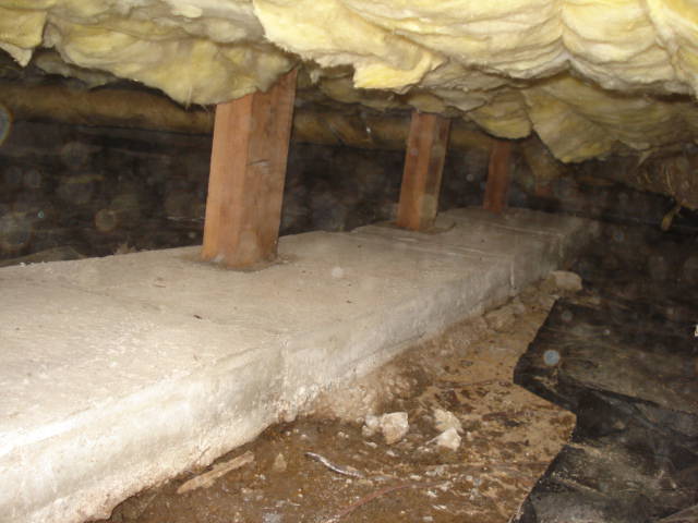

randynavarro Posted November 5, 2008 Report Share Posted November 5, 2008 Found this today in a crawl space. I've never seen anything like it. Image Insert: 146.78 KB Image Insert: 143.47 KB Image Insert: 150.48 KB Image Insert: 148.55 KB My theory: they poured it in the wrong spot. Then used a backhoe or some machine to drag it over to the right spot which caused the busting and cracking. Any other ideas? Quote Link to comment Share on other sites More sharing options...
Chad Fabry Posted November 5, 2008 Report Share Posted November 5, 2008 Don't you people have a frost line? It looks like a cheesey 5 inch thick slab on grade ...with control joints? What's that all about? It also looks like they used native soil for the coarse and fine aggregates. Quote Link to comment Share on other sites More sharing options...
MTL_Inspet_Man Posted November 5, 2008 Report Share Posted November 5, 2008 This footing not only does not have proper support. should have bee ndug down. Also no indication of rebar and the concrete appears to be not of the proper strength. Also did not know they allowed wood to be sunk in direct contact with concrete. Quote Link to comment Share on other sites More sharing options...
hausdok Posted November 5, 2008 Report Share Posted November 5, 2008 OK, OK, elitist northeast snobs, It's a grade beam and no, we don't have a frost line in the western corridor. Well, maybe just a bit - a few inches or so on the coldest day of the year - if it's not raining. However, in that crawl temps will rarely get less than 50°F. It's nothing more than an elongated pad footer and it's on undisturbed soil where they excavated for the foundation. Some folks sink 'em, others don't. A whole lot of 'em use these large round cardboard box forms, about a foot deep by 3ft. in diameter, place them directly on the soil, fill them with concrete and criscross a few pieces of rebar in them before the concrete sets up. Depending on drainage around and under the house, pier pads will either settle or not; one of these beams rarely settles 'cuz it distributes the weight over such a long wide footprint. The crack, though it's unusual, wouldn't concern me in the least. It's got rebar inside of it; I'd bet a case of whatever you drink on it, and the wood is not in direct contact - if you look closely you'll see that they've placed squares of asphalt under the ends of those posts. I'd like to know how you've managed to analyze the strength of the concrete via a photograph. That's a pretty good skill; if I could learn that, maybe I could learn to predict sports outcomes, bet on them and become an overnight millionaire. That looks like a plank-on-frame floor platform - something else that would probably freak you guys out a little. You guys'd probably really freak out if you were to see them forming up foundations around here with hand-built ordinary oiled plywood and 2 by 4 forms. I know my Dad did when he was out here to visit a few years ago. Being the owner of a big expensive truck full of forms, he couldn't imagine that folks were still doing it that way. Randy, Richard, Brad, we need to really freak these folks out. Do any of you have any pictures of post WWII plank-on-frame floor platforms with the little verticle 2 by 4 mudsills let into the top of the foundation wall to show the Easterners? ONE TEAM - ONE FIGHT!!! Mike Quote Link to comment Share on other sites More sharing options...
Jeremy Posted November 5, 2008 Report Share Posted November 5, 2008 It's ugly but functional. Looks like a bunch of individual pours with cold joints to me. Quote Link to comment Share on other sites More sharing options...
hausdok Posted November 5, 2008 Report Share Posted November 5, 2008 If you look closely, you can see the stamping. Oh, by the way, the trough across the top of the beam is so that if the crawl fills with water the water will flow over the beam and into the next bay without getting on top of the beam and causing the end of the post to get wet and rot. It works great when the total amount of infiltration is only a few inches but it's useless if the crawl fills to a depth higher than that beam. The vapor barrier placement is crap. Quote Link to comment Share on other sites More sharing options...

randynavarro Posted November 5, 2008 Author Report Share Posted November 5, 2008 Here's some more pics. Image Insert: 141.22 KB Image Insert: 147.01 KB It's unusual to me as the other beam/footer in the crawl space was undisturbed with no cracking. It looks as though some of the breaks/cracks are intentional while others appear to be a result of simple movement. Oh yeah. And everything Mike's already said. Image Insert: 156.16 KB Quote Link to comment Share on other sites More sharing options...
hausdok Posted November 5, 2008 Report Share Posted November 5, 2008 Hi, You never know, it might have been the Nisqually. Lots of stuff got jostled around in that sucker. OT - OF!!! M. Quote Link to comment Share on other sites More sharing options...
