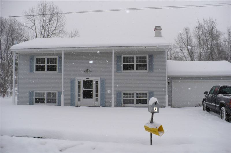

Scottpat Posted November 21, 2008 Report Share Posted November 21, 2008 When you say "raised"ranch, do you mean split level on a slab foundation or part slab and crawl? Are the water lines in the slab? Quote Link to comment Share on other sites More sharing options...
gtblum Posted November 21, 2008 Author Report Share Posted November 21, 2008 Hi scott, It's a true raised ranch with a full basement living space. Image Insert: 57.88 KB (1967) Quote Link to comment Share on other sites More sharing options...
Scottpat Posted November 21, 2008 Report Share Posted November 21, 2008 What's all that white stuff? Looks like the Stay Puff Marshmallow man had an accident![] I don't have a clue as to what could cause it, but that snow does give me a few ideas. Quote Link to comment Share on other sites More sharing options...
gtblum Posted November 21, 2008 Author Report Share Posted November 21, 2008 Originally posted by Scottpat What's all that white stuff? Looks like the Stay Puff Marshmallow man had an accident![] That's no accident. The forcast for tonight is that he has diarrhea. Quote Link to comment Share on other sites More sharing options...
