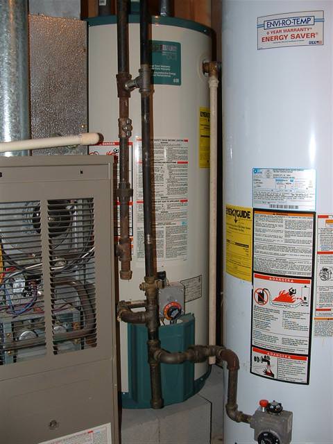

Chad Fabry Posted July 20, 2004 Report Share Posted July 20, 2004 This was a funky set up in series, two different heaters, two brands, two sizes. They are plumbed in series but the gas piping and flue arrangement have me a little perplexed. Hopefully the photo quality is good enough for you guys to get a handle on this and advise me. Two gas pipes run from a the main gas line, and between the two pipes is another H assembly..is this to ensure equal pressure to both units? The other thing is we now have a 35k Btu wh, a 40k Btu water heater and a 50k Btu furnace all on the same vent. Please observe and advise. Thanks ... Oh and tell me if the the NM cable can be fastened to the return for the furnace?..you can see it in the photos. It all looks crude and crowded to me. Download Attachment: wh1.jpg 56.96 KB Download Attachment: wh2.jpg 46.56 KB Download Attachment: wh3.jpg 56.55 KB Download Attachment: wh4.jpg 52.48 KB Download Attachment: elc1.jpg 52.86 KB Quote Link to comment Share on other sites More sharing options...
Brian G Posted July 20, 2004 Report Share Posted July 20, 2004 Just off the top of my head, but I'm sure that T in the second photo should be directional. I notice the relief valve piping doesn't go anywhere (like say, the exterior). Brian G. Quote Link to comment Share on other sites More sharing options...

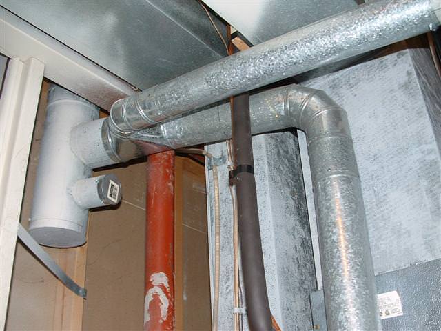

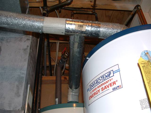

crusty Posted July 21, 2004 Report Share Posted July 21, 2004 Chad, It looks like a jimmy rigged set up. If my eyes don't deceive me the flue connector for the 2 water heaters is too small (requires area of larger + 50% of smaller) It looks like 2-4"? At the juncture the flue connector needs to increase in size. I will also bet if the calcs are run the gas pipe is not properly sized either. It looks to me like they simply added the larger heater as an after thought utilizing the existing gas and flue piping. Is that a tin can in the flue connector? A union in the gas line? I would call it for the POS it is and defer the entire installation. Quote Link to comment Share on other sites More sharing options...
kurt Posted July 21, 2004 Report Share Posted July 21, 2004 In addition to the above, what about the (apparently) single wall flue in contact w/ combustibles in the wall cavity? Even if it's a B vent, you still need minimum 1" clearance to combustible, & it doesn't look like you have it. Nasty setup; buncha wrong stuff. Quote Link to comment Share on other sites More sharing options...
Jim Katen Posted July 21, 2004 Report Share Posted July 21, 2004 · If they’re plumbed in series, there’s no problem with using different sizes & brands of water heaters. · Is there enough combustion air in the room for all this crap? · The single wall vent connectors need 6 inches of clearance to combustibles. That includes the Romex and the refrigerant line set insulation. If that’s a B-vent that they lead to, it needs 1 inch of clearance to both the wood framing and the drywall. · The sizing of the vent connectors looks wrong. As Crusty pointed out, there should be an increase at the tee. (Which would work better if it were a wye, by the way.) Venting multiples is tricky. Remember that the vent has to draw well with all three appliances running as well as with the single smallest one running alone. The tables are in NFPA 54. Have fun. · With the exception of that weird “H†Quote Link to comment Share on other sites More sharing options...

Terence McCann Posted July 21, 2004 Report Share Posted July 21, 2004 Just a few other items... When feeding two appliances with one gas line the main run should be larger and then stepping down as it feeds the devices. God only know why they put the jumper in line. Are you sure both lines are main feeds and they just didn't use the jumper as a feeder for one or the other lines? I have an old plumbers manual, from East Ohio Gas, that has charts on proper gas line sizing. If you don't have something like this Chad I can scan & send you a copy. One heater looks like it has a copper drain line for the TPRV & the other has plastic. It may be nit picking but I like to see copper on the drain lines. Quote Link to comment Share on other sites More sharing options...
crusty Posted July 21, 2004 Report Share Posted July 21, 2004 FWIW Chad. Unless you want to go through the exercise of sizing the gas pipes as a learning experience, there is enough wrong here to note the concerns and defer the entire 3 appliance installation citing the improper addition (no doubt performed without the benefit of permits and inspection) of the newer water heater. Sizing gas lines is well beyond the scope of a property inspection IMO. By the way. This looks like a garage installation and the big one appears to be sitting on the floor. That in itself is enough to defer the installation for further evaluation by a qualified licensed plumber. Steve Quote Link to comment Share on other sites More sharing options...

Chad Fabry Posted July 21, 2004 Author Report Share Posted July 21, 2004 It's a basement install. It bothers me some that all three pilot lights are in the same 8x12 room, and I had concerns about combustion air as well. The gas piping to my eye is adequate for the total draw, there's a one inch main and the appliance piping is 3/4 inch. Terry, I'd like that sizing chart because I'm about to install 170k Btu demand water heater, and want to make sure it's OK to plumb off a 1 inch main w/ the 145kBtu furnace. Quote Link to comment Share on other sites More sharing options...

RobC Posted July 22, 2004 Report Share Posted July 22, 2004 Chad, You have quite a puzzle here! Although the gas lines 'look' convoluted I wouldn't concern myself with it. I see drip legs of different lenghts that may indicate the quality of the gas fitter and the state of his truck and supplies arrangement..etc. I think you will relate to this as you are a tradesman yourself, the impression I get from your shop photos. Photo No. 1 I see the setting knob set at an extreme. Was it set at minimum or maximum? I suspect this tank is the secondary in the series, what temperature did you record at the faucets? I sense both tanks were set at maximum. Photo No. 2 bleeds with infractions. 1. T connection - not allowed 2. Small section - seam pointing wrong way 3. Insufficient fasteners at connections-three screw EVENLY SPACED around the clock (not at 3, 6 and 8 o'clock, thank you!) Photo No. 3 Bells- They are a ringing 1. Clearance to combustibles (as previously mentioned)- the base T' is of concern here and tells me that no inspection was conducted on this project. 2. Suction line insulation proximity to the 375 degree vent- unprotected..... 2. The 45 degree boot is questionable. Did you squeeze it to ensure that is was C' vent material? I'll bet a beer it's a duct fitting. 3. The 4" cap is not fully seated into the base. I'll bet you another beer there is only two screw at the joint. Photo No. 4 My favorite 1. Unsupported vent connector 2. Unprotected conductors (below 5' here). 3. Dedicated furnace switch tapped. 4. AND most importantly- This is where you have to send the children to bed and keep the women from reading this 'FAT GIRLS AT THE BOTTOM' or The largest (BTU) appliance is always at the bottom of the flue or chimney. The installation is parallel and not proper. Photo No 5. You mentioned, this is a basement The TPR discharge pipes are directed inside. So, why do we have a condensate pump? OR Is it necessary where you are? AND The whole thing apppears to be in an enclosed room as evidenced by the door jamb and stricker plate. Do we have sufficient combustion air provision? I have a few more questions........but I forgot Something to do with the tank shut off valves on the hot side and not on the cold side. I hope you wear steel toed boots on your inspections. .......I would. BTW I was most impressed with your CA post Don't leave it in the rain........please Quote Link to comment Share on other sites More sharing options...

RobC Posted July 23, 2004 Report Share Posted July 23, 2004 I see in my rush, I wasn't quite specific with the temperature note. Whenever I see two water heaters in series I immediately check the temp setting knob on both of them. That tells me lots. This is the way I design them (actually my plumber's design). The first (primary) tank is set at 90 degree F and the second at 125 degree F, for this reason. As cold water is warmed in the primary tank, minerals will flocculate and settle to the bottom. This is what 'kills' a heater, over time mineral buildup interferes with the heating process and eventually leaks occur etc.. The second tank is there to finish the heating process and sees mainly 'clean' water. In other words, the secondary tank is on vacation, the primary tank is the one that does most of the work - heating water from approx 38 to 90 degree F or a 50 degree temperature difference. Here is a gas line chart, (sorry about the quality, it's a scan, another unfinished project) Download Attachment: GasLine Chart_M.jpg 49.86 KB Quote Link to comment Share on other sites More sharing options...
Jim Morrison Posted July 23, 2004 Report Share Posted July 23, 2004 Rob, I don't understand the benefit of your setup. Your first tank heats the water about 50 degrees, the second tank heats the water 30 degrees. How is that better than a parallel setup? I figure that the only reason for installing two tanks is for a large demand. Two 40 gallon tanks piped in parallel gives you 80 gallons of hot water on demand. Piping them as you described gives you 40 gallons of hot water (albeit with super quick recovery), so why not simply install one tank? Also, I want to thank you for giving me a stellar idea. If my dream of an all-home-inspector rock and roll band comes true one day, we will be called: "The Flocculators". All resumes should be sent to me care of this web site. Quote Link to comment Share on other sites More sharing options...
Mike Keady Posted July 23, 2004 Report Share Posted July 23, 2004 A. O. Smith recommends parallel piping. I see both in new homes. Mike Keady http://www.hotwater.com/bulletin/BULLETIN%2064.pdf Quote Link to comment Share on other sites More sharing options...
