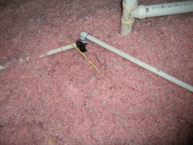

charlieb Posted April 25, 2009 Report Share Posted April 25, 2009 Lookin for a bit of help here. My question relates to air gaps and air breaks. What is required for the condensate discharge from an AC unit? Click to Enlarge 77.26 KB Quote Link to comment Share on other sites More sharing options...
inspector57 Posted April 25, 2009 Report Share Posted April 25, 2009 Depends on your local AHJ interpretation. Around here, all municipalities are ok with attic units draining into the tail piece of a downstairs bathroom sink. Of course I am in the land of slab foundations and we never have basements with floor drains and such. Quote Link to comment Share on other sites More sharing options...
charlieb Posted April 26, 2009 Author Report Share Posted April 26, 2009 Depends on your local AHJ interpretation. Around here, all municipalities are ok with attic units draining into the tail piece of a downstairs bathroom sink. Of course I am in the land of slab foundations and we never have basements with floor drains and such. I've heard of this method but down here in the land of hall closets and attic installs it is always stubbed into an open trap. I interpret that as an air break but was having a debate with another inspector. Seldom is a trap installed in a discharge line. Download Attachment: DSCN2134.JPG 89.83 KB Quote Link to comment Share on other sites More sharing options...
