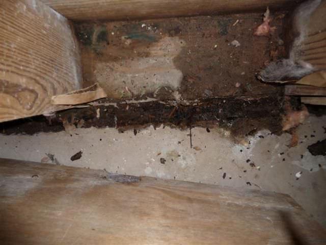

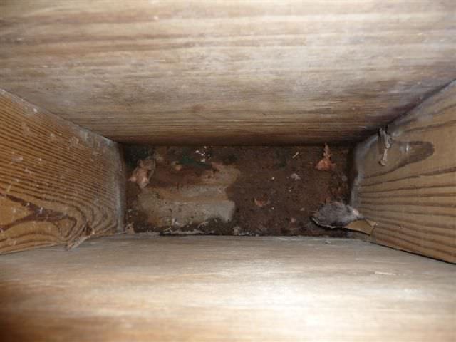

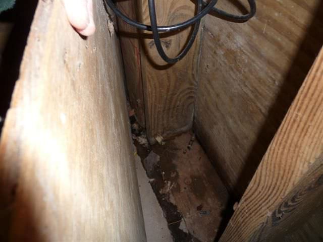

gtblum Posted October 5, 2009 Author Report Share Posted October 5, 2009 I was able to see down through only two of the wall cavitys. Luckily they happened to be in the area of most concern. I got a little invasive and took the inside panel off to get a better look. The first thing I noticed was, it looked like the the poly had been wrapped completely around the footing plate instead of being draped over the outside edge like every illustration in the pdf. That makes me wonder if after 20 years of sliding around on the gravel under it, It wore through and is now holding moisture against the bottom of the plate. The rotted wet wood you see is the form for the pad. It's wicking water from below and it's saturated. The walls, insulation and bottom plate were not wet other than at the very bottom. The windows had plastic wrapped to the inside and everything was bone dry. It's really a pretty cool system but, if it was my house, It would be on a solid concrete footer. Click to Enlarge 79.14 KB Click to Enlarge 76.09 KB Click to Enlarge 67.84 KB Click to Enlarge 43.14 KB Click to Enlarge 43.65 KB Click to Enlarge 47.63 KB Click to Enlarge 67.39 KB Quote Link to comment Share on other sites More sharing options...

gtblum Posted October 6, 2009 Author Report Share Posted October 6, 2009 So, what'd you say about it to the customer? At time with dad on my shoulder, pretty much what I've written here so far and that although there was very little water it's not going to get better by itself. We've had a whole week of heavy soaking rain around here. Couldn't have picked a better time to look at it. I honestly think the biggest problem is that the poly is deteriorating at the bottom.There was so much I couldn't see because most of the basement had finished walls. It was very frustrating. The house sits on a small hill and should have no issues if everything you can't see was done properly. I looked at aerial photos and topo maps of the area ahead of time. There's one pond about a mile up the road. Every thing around the house is lower and dry. Christmas decorations and most of the other stuff I saw was stored on the floor not on pallets. Starting the report in the morning. I'll write what I saw. At least I had a heads up on what I was walking into this time. Quote Link to comment Share on other sites More sharing options...
kurt Posted October 6, 2009 Report Share Posted October 6, 2009 Yeah, it's probably not totally screwed right now, but it's going to be totally screwed in a decade or so. All the little leaks, poly failure, and soaking conditions eventually force it into a slow death. I'm with Jimmy. It's a disposable foundation, which would be just fine if all that house wasn't sitting on top of it. Quote Link to comment Share on other sites More sharing options...

gtblum Posted October 6, 2009 Author Report Share Posted October 6, 2009 I'm with Jimmy. It's a disposable foundation Yes and no. It really looks like it could work as well as any other as long as it's protected by something more than a sheet of plastic. That alone has got to be the biggest down fall of the system. Even if it's installed perfectly, the very first load of gravel dumped is going to damage it. Seems to me if the same methods of water proofing a conventional foundation were applied, there might be some advantages to building with wood. Wood doesn't step crack. Quote Link to comment Share on other sites More sharing options...
