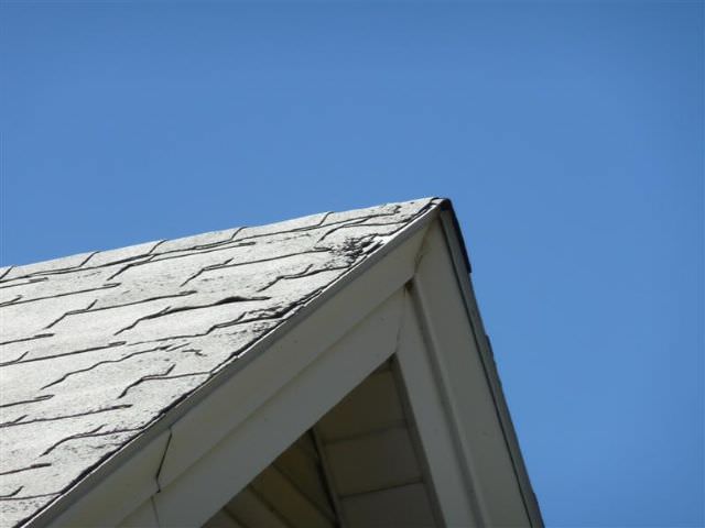

gtblum Posted October 19, 2009 Report Share Posted October 19, 2009 Do they still make these? If they don't, how about a time line and the proper name for the style. Thanks Click to Enlarge 27.94 KB Quote Link to comment Share on other sites More sharing options...
Brad Manor Posted October 19, 2009 Report Share Posted October 19, 2009 They look sorta like Iko interlocking shingles. -Brad Quote Link to comment Share on other sites More sharing options...
Bill Kibbel Posted October 19, 2009 Report Share Posted October 19, 2009 Do they still make these? Up until recently, Certainteed and Tamko were making them. There might be some still available, but I don't think anyone is manufacturing them now. If they don't, how about a time line and the proper name for the style.Interlocking asphalt shingles were manufactured from the mid 1920s until very recently. In the late '90s, I saw one still in service that was documented as having been installed in 1929. At one time, they were affectionately referred to by those in the industry as cereal box-top shingles. Since the process of applying seal-strip adhesive was developed, the popularity decreased. Now with dimensional shingles being the most popular, interlocking shingles are no longer in demand. The interlocking shingles in your picture look like the type referred to as "T-lock". Tamko still made T-loc shingles until recently. Quote Link to comment Share on other sites More sharing options...
gtblum Posted October 19, 2009 Author Report Share Posted October 19, 2009 You are the man. "T lock" Knew I'd heard that before. There are actually quite a few homes around here with them. They all look fifty years old and in pretty fair shape. I Got to believe the roof pitch has something to do with their longevity. This one is of course is, how shall I put it? SHOT! Quote Link to comment Share on other sites More sharing options...
Bill Kibbel Posted October 20, 2009 Report Share Posted October 20, 2009 There are actually quite a few homes around here with them.They were most popular in high-wind areas. I'm guessin' Oswego might get an occasional breeze bein' next to that little pond. Quote Link to comment Share on other sites More sharing options...
Jim Morrison Posted October 20, 2009 Report Share Posted October 20, 2009 In and around Boston, they're referred to as 'Hurricane shingles' and they routinely last 40+ years. Quote Link to comment Share on other sites More sharing options...
hausdok Posted October 20, 2009 Report Share Posted October 20, 2009 Hi, Get a copy of The Roofer's Handbook by W.E. Johnson (Craftsman books). It's got a whole section on T-lock shingles. I don't know if they're still popular there, but when I lived in Colorado in the mid 1990's those were the shingles of choice around Colorado Springs because of the high wind conditions. There's a company in the mid-west that still produces them and installs them. http://squiresroofing.com/interlock_shingles.htm ONE TEAM - ONE FIGHT!!! Mike Quote Link to comment Share on other sites More sharing options...
