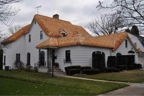

hausdok Posted January 11, 2010 Report Share Posted January 11, 2010 Here's a roof that I think TIJers would love to inspect. Karen Rotter of Manitowoc, WI is enjoying a new cedar shingle roof this winter that duplicated the thatched-look shingle roof that had been on her home for the past 85 years. Shingle thatching is a technique that's been around for about a hundred years. Back in the early part of the twentieth century we didn't have a lot of thatchers in this country but we had an abundance of roofers accustomed to installing cedar shingles. So, when some homeowners wanted thatched roofs, roofers here tried to duplicate the look of a thatched roof with cedar shingles instead. Most of these old thatch-look roofs are long gone; so, when Mrs. Rotter decided she wanted the same roof she turned to Brandon Bartow, president of Bartow Builders, Manitowoc. Bartow decided that he could duplicate the look but it wasn't easy - he literally had to invent a special press and clamp to form the shingles and then boiled them right there on the front lawn, formed them and then installed them. To read more about this unusual roof cover, click here. (Many thanks to Mrs. Rotter for allowing TIJ to re-print the photo of her house for this story.) Link to comment Share on other sites More sharing options...
Terence McCann Posted January 11, 2010 Report Share Posted January 11, 2010 No gutters eh? I've seen a few homes around this area with the same type of design - must be an acquired taste. Link to comment Share on other sites More sharing options...
AHI in AR Posted January 11, 2010 Report Share Posted January 11, 2010 Well, I guess when you get 80+ years out of the original roof you can afford a one-off custom roof! Seriously, though, you gotta give kudos to the contractor for tackling the challenge and designing a system to do a job that neither they - nor anyone else within recent decades - had done. Link to comment Share on other sites More sharing options...
Richard Saunders Posted January 12, 2010 Report Share Posted January 12, 2010 It looks especially nice with the white vinyl siding! Link to comment Share on other sites More sharing options...
Inspector37620 Posted January 12, 2010 Report Share Posted January 12, 2010 There was a house in Independence, MO that had a roof like that, from a distance you would swear there was a problem with the roof. But it was all done properly. We called it the smurf house. Link to comment Share on other sites More sharing options...
Jim Baird Posted January 12, 2010 Report Share Posted January 12, 2010 There's just no accounting for taste! That roof sits up there just like matress would on top of a bottle of wine! Link to comment Share on other sites More sharing options...
Marc Posted January 12, 2010 Report Share Posted January 12, 2010 On the bell curved rakes, the direction of rainwater flow is at an angle to the shingle, up to 90 degrees off, which violates a cardinal rule in shingling. The contractor must have flashed each and every rake in order to make sure that the water would shed properly. That's a lot of copper. Marc Link to comment Share on other sites More sharing options...

Marc Posted January 12, 2010 Report Share Posted January 12, 2010 Wow! It almost looks monolithic. Marc Link to comment Share on other sites More sharing options...
Ben H Posted February 23, 2010 Report Share Posted February 23, 2010 That is cool, looks like it was poured out of a bottle... Link to comment Share on other sites More sharing options...
thomop Posted May 6, 2010 Report Share Posted May 6, 2010 I love a roof without gutters. Gives it such a natural feel. Just look out for the water fall when going in your front door during a rain storm!! Link to comment Share on other sites More sharing options...
roofingcolorado Posted May 14, 2010 Report Share Posted May 14, 2010 That's a gorgeous roof! It's quite unique and looks very costly as well. In Denver Colorado there are quite a few similar roofs near Washington Park but after they install it, they cut out curves in the wood shingles which gives it a very unique, wavy look. Does anyone know what that type of roofing is called? Or what the cost is? Link to comment Share on other sites More sharing options...
