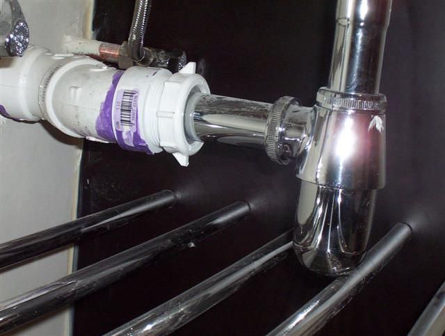

Mike Lamb Posted January 24, 2010 Report Share Posted January 24, 2010 Click to Enlarge 42.49 KB I suppose this is a trap I have not seen before. Does someone have more info or a link? Link to comment Share on other sites More sharing options...
mgbinspect Posted January 24, 2010 Report Share Posted January 24, 2010 I've seen similar units in old rIchmond row houses, but they are typically made of galvanized steel. I've never seen one of chrome like that. The old galvanized ones could actually be cleaned out by simply removing a bottom threaded cap, which seemed like a nice feature. I doubt very any folks actually didit, though. Link to comment Share on other sites More sharing options...
Scottpat Posted January 24, 2010 Report Share Posted January 24, 2010 I have seen somthing very similar in a dental lab. The bottom part collects gold, etc that gets washed down the drain. Link to comment Share on other sites More sharing options...
Jim Katen Posted January 24, 2010 Report Share Posted January 24, 2010 I suppose this is a trap I have not seen before. Does someone have more info or a link? I've been seeing a bunch of those lately on high-end fancy-dandy lavatories with exposed plumbing. No one wants to look at an ugly p-trap in a $100,000 bathroom. Of course the lovely PVC fittings with the price tags still on them kind of offset the effect. - Jim Katen, Oregon Link to comment Share on other sites More sharing options...
Richard Moore Posted January 24, 2010 Report Share Posted January 24, 2010 Mike...google "bottle trap". They are decorative traps often used where the drain will be visible. Often used with fancy schmancy vessel sinks on glass counters, etc, etc. It is a p-trap and works the same way. The much sharper bend would seem prone to hair clogs, but I don't know if that's a problem or not(?) Link to comment Share on other sites More sharing options...

Mike Lamb Posted January 25, 2010 Author Report Share Posted January 25, 2010 Thanks. "Bottle trap," it is. Link to comment Share on other sites More sharing options...
