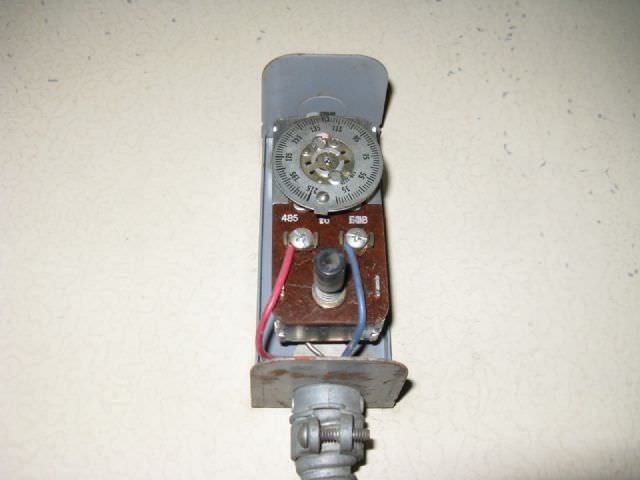

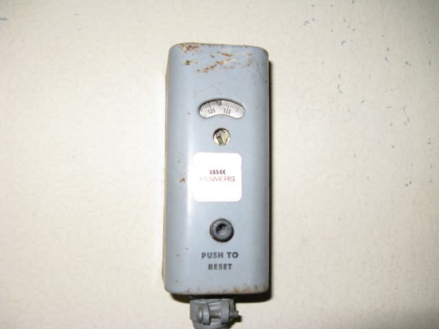

MPdesign Posted February 25, 2010 Report Share Posted February 25, 2010 I was looking at a large ventilation fan in a sidewall of a parking deck. Does anyone know what this controller is? The dial goes from 35 to 215. Thank you! Click to Enlarge 25.87 KB Click to Enlarge 30.81 KB Link to comment Share on other sites More sharing options...
Bryan Posted February 25, 2010 Report Share Posted February 25, 2010 It look like a line voltage temperature control thermostat. Link to comment Share on other sites More sharing options...
MPdesign Posted February 25, 2010 Author Report Share Posted February 25, 2010 That was my first thought but the dial goes to 215. I guess that could be because it is an "industrial control". That is a little crazy high. Is anyone sure that this is a thermostat? I am also wondering if it could possibly be a Carbon Monoxide sensor. Alternatively if you are not sure what it is - BUT if you know it is NOT a CO sensor, please post. This should have a CO sensor but this is all that I see on it. Built in the 80's. Thanks Link to comment Share on other sites More sharing options...
Bill Kibbel Posted February 25, 2010 Report Share Posted February 25, 2010 It's a Honeywell aquastat with manual reset. There's an immersion sensor bulb behind it. It's usually installed to limit or regulate the temperature of boilers, but I've also seen them used in ducts in very large forced-air heating systems. Link to comment Share on other sites More sharing options...
MPdesign Posted February 25, 2010 Author Report Share Posted February 25, 2010 Thank you. I thought it was - but I do not like to guess. On another note, I am finding that carbon monoxide sensors are in the range of $1,000. This is certainly not a $1,000 device. Link to comment Share on other sites More sharing options...
