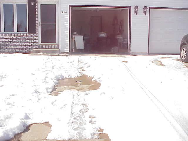

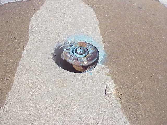

barlyhop Posted March 2, 2010 Report Share Posted March 2, 2010 I ran into something new today. The curb stop was situated in a concrete driveway directly in one of the wheel paths. The slab has cracked and settled leaving the cap of the curb stop about 3/8" above the surface. The house was vacant, so I don't really know when the problem occurred. There was no evident damage noted. Coincidentally, the city showed up to turn the water on for the inspection while I was there. I asked them about it and they said it's not a problem for them and stated that damage would not be unlikely as it is "only the cap" I informed the buyer to speak with the city utility about it before closing. Click to Enlarge 61.58 KB Click to Enlarge 34.62 KB What would you think about this? Quote Link to comment Share on other sites More sharing options...

plummen Posted March 2, 2010 Report Share Posted March 2, 2010 its common to see them slightly above the surface depending on who installed it or the driveway. as long as its clear of concrete around the diameter ill usually just lay a 2x4 on top of it and give it a couple thumps with a 2lb sledge depending on how easy it moves. the stopbox basically a piece of pipe with a squashed end that telescopes inside another pipe,normally they are extended all the way so there is usually 12" or so of play in there. ive got 5-6 stop box replacements allready lined up ,just waiting on snow to melt so we can start on them Quote Link to comment Share on other sites More sharing options...
Tom Raymond Posted March 2, 2010 Report Share Posted March 2, 2010 The gas stop cover is in a similar place in my driveway, it makes a hell of a racket when it goes through the snowblower or the lawn mower. The tractor tires are soft enough to grip and lift it, and it happens more often than you'd think. Tom Quote Link to comment Share on other sites More sharing options...
