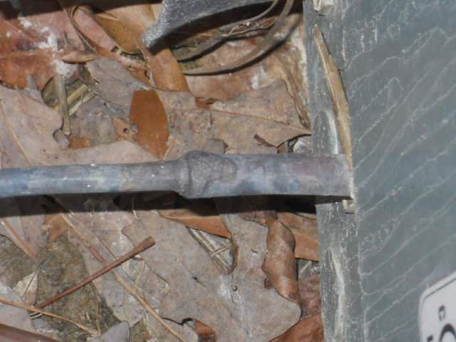

mgbinspect Posted March 5, 2010 Report Share Posted March 5, 2010 OK, I suspect this has probably been addressed before, BUT WTH... This is something I only see a couple times a year and I always call it out - line set diameters that don't match the diameter of the evaporator or condensing unit coil tubing. It seems that it would logically HAVE to affect some aspect of heat pump or air conditioner performance since the volume of the tube is different - maybe the velocity at which refrigerant flows to meet compressor demand is increased or pressures can't be achieved or maintained... That's why I'm posting this. Click to Enlarge 59.16 KB Click to Enlarge 53.6 KB Again, I do always call it out and refer folks to a HVAC specialist, but I really want to hear from the HVAC trained brain-trust technically what is affected and why? Lay it on me! Link to comment Share on other sites More sharing options...
Marc Posted March 5, 2010 Report Share Posted March 5, 2010 I'll take a stab at it, my friend. The smaller line is the liquid refrigerant line. It carries liquid refrigerant to the cooling coil (summer mode) for expansion into a gas. That's the principle of refrigeration systems...the change in phase from a liquid to a gas is accompanied by a dramatic reduction in temperature of the refrigerant and that drop in temperature is employed to cool the house. This change in phase from a liquid to a gas is accomplished by placing a restriction in the flow of the refrigerant that causes it's pressure to drop to a low value. Therein lies the problem with undersized liquid refrigerant lines...there is pressure drop within those lines also and if the line is too small for too long, the pressure drop may be great enough to result in a partial expansion of the liquid refrigerant (bubbles in the liquid) inside the liquid line before it even reaches the cooling coil. The result is less btu/hr removed from the house. How do we know if expansion is taking place within an undersized liquid line? Feel it. If it's cooler than usual or cooler as it approaches the cooling coil, it's expanding and it's always a problem when this happens. Marc Link to comment Share on other sites More sharing options...
mgbinspect Posted March 5, 2010 Author Report Share Posted March 5, 2010 So then, do you feel that it's legit to always make a Pretty Big Deal about this condition? And, why the H*LL do alleged licensed professional HVAC contractors pull this shite? I suppose the contractor was too lazy to change out the line set? or, it was the only one he had with him and just didn't care to go back to the shop for the right set? It's really annoying... [:-banghea Link to comment Share on other sites More sharing options...
Marc Posted March 5, 2010 Report Share Posted March 5, 2010 I see undersized liquid lines on smaller systems once in a while. I check them and seldom detect bubbles in the liquid. Experienced AC guys can usually 'feel' bubbles by touch, at least the deaf ones with their redirected senses can. I don't bother with mentioning it to the client, but I'd suggest that if you do see undersized lines (1/4" line on a crimped or reducer-connected 3/8th appliance connection) on any residential system larger than 2 1/2 tons, call it, regardless of whether you feel bubbles, cooler lines or nothing. Marc Link to comment Share on other sites More sharing options...

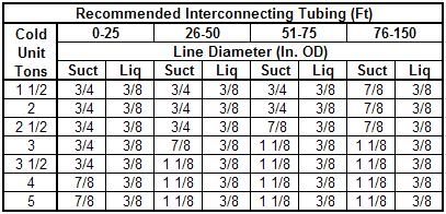

Bain Posted March 5, 2010 Report Share Posted March 5, 2010 Well, but it's not always wrong. It looks like the reduction in your photo is from 3/4" to 5/8", which is sometimes necessary due to the refrigerant line lengths and/or the elevation differential between the condenser and the evaporator coil. I'm including a link that should prove helpful and explain things much more succinctly than I could. Check out page three, specifically "Line Sizing." Oftentimes, but of course not always, altering the refrigerant-line size is a sign of competence and responsibility, rather than the opposite http://www.colemanac.com/PDFFiles/247077-UAD-H-0209.pdf Link to comment Share on other sites More sharing options...
mgbinspect Posted March 5, 2010 Author Report Share Posted March 5, 2010 You're on target, Marc These were two 1.5 ton units. One was 1993 (original) and the other 2005. I'll take your recommendation regarding 1/4" to 3/8" lines to the bank. Thanks! [:-graduat Link to comment Share on other sites More sharing options...
mgbinspect Posted March 5, 2010 Author Report Share Posted March 5, 2010 Bain, I guess it's difficult to gain any perspective from the photos. The smaller line diameter is probably no more than maybe 3/16" to 1/4" - as small as I ever see... and it is on a 1.5 ton unit, if that helps. I'll check out the link. I've just never known for certain if the line diameter of the coil is "the gospel", or just the largest recommended diameter, but using a smaller line diameter can be OK. I'm afraid I didn't remove insulation to check the suction line diameter to see if it is also undersized, and kinda wish I had now just for further discussion's sake. Link to comment Share on other sites More sharing options...

inspector57 Posted March 5, 2010 Report Share Posted March 5, 2010 I'm with Bain on this one, It is not always wrong. Now if you see a hunk of tubing half the size of the line and unit size stuck in place of where the drier used to be that is an obvious hack job, then call it out. On the other hand if the line set is one size larger or smaller than the condensing unit stubs then it may be right. I personally don't get excited unless the unit is not cooling properly. But here in the land of perpetual A/C, it is rare that a line set is undersized since we try to wring every BTU out of units and they get a good test every season. Without the manufacturer specs on the individual unit, line set length, and diameter you are pretty much shooting in the dark. Given your photo of this specific installation it looks like the cut out a filter drier and replaced it with the first hunk of pipe off the truck. Ugly and not correct but unlikely to cause any real difficulty given the short length of the smaller tubing. Link to comment Share on other sites More sharing options...

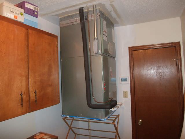

Marc Posted March 6, 2010 Report Share Posted March 6, 2010 I replaced my own central HVAC with an R-410 based AC/ electric heat system 2 years ago. Click to Enlarge 36.66 KB Both inside and outside units are the quietest I've experienced of any AC I've ever come across. No factory jacket on my compressor. Hasn't given an ounce of trouble yet. As for losing gas when you connect or disconnect the guages, EPA has required quick connect devices for quite some time now. Never liked 'em but supposed to use them. Marc Link to comment Share on other sites More sharing options...
