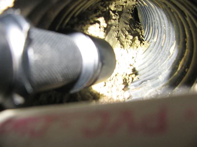

Mark P Posted March 10, 2010 Report Share Posted March 10, 2010 The bottom of the sump has a lot of mud inside. The drain tile enters the sump from two sides. One side is clear the other is filled with mud. Hose built in 1994. No signs of any water intrusion problems. What does the mud mean and how did it get in there? Any ideas are appreciated especially since my customer is the city attorney? Click to Enlarge 40.31 KB Click to Enlarge 64.86 KB Quote Link to comment Share on other sites More sharing options...
hausdok Posted March 11, 2010 Report Share Posted March 11, 2010 It means that they put a drain system in without a sleeved pipe or filter fabric around the swales to keep the fines out and water washing into that sump is carrying the soil with it. ONE TEAM - ONE FIGHT!!! Mike Quote Link to comment Share on other sites More sharing options...
kurt Posted March 11, 2010 Report Share Posted March 11, 2010 Yep, and it can't be fixed. Quote Link to comment Share on other sites More sharing options...
Ben H Posted March 11, 2010 Report Share Posted March 11, 2010 Yep, and it can't be fixed. Ooooh...That Sucks. Quote Link to comment Share on other sites More sharing options...
Jerry Simon Posted March 11, 2010 Report Share Posted March 11, 2010 Coulda easily just been dirt that got into the drain tiles while they were lying around the construction site prior to install. If not, expect to see the flatwork about the perimeter of the house start to sink someday from the loss of soil below. Have a camera run through the drain tiles to check their condition, to see if they're full of dirt/mud/soil. If they're clear, I wouldn't worry, 'specially if the house is more than a couple years old. That said, sometimes it's hard to get a camera snaked through corrugated drain tiles. Quote Link to comment Share on other sites More sharing options...
Tom Raymond Posted March 11, 2010 Report Share Posted March 11, 2010 Yep, and it can't be fixed. Sure it can. All you need is a jack hammer, a bunch of 5 gallon buckets, and a truck load of illegals to muck it all out. Or you could call Mike Holmes and he'll bring all that stuff for you, but I'm not sure I could put up with a camera crew in my basement[] Tom Quote Link to comment Share on other sites More sharing options...
Jerry Simon Posted March 11, 2010 Report Share Posted March 11, 2010 Yep, and it can't be fixed. Sure it can. All you need is a jack hammer, a bunch of 5 gallon buckets, and a truck load of illegals to muck it all out. Or you could call Mike Holmes and he'll bring all that stuff for you, but I'm not sure I could put up with a camera crew in my basement[] Tom I was assuming exterior drain tiles, not interior. I also didn't look at the one pict. showing a mud-clogged tile. Anywho, fixing exterior ones means lots & lots of diggin', but we all knows dat. Quote Link to comment Share on other sites More sharing options...
