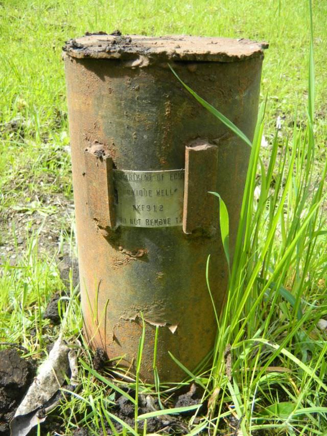

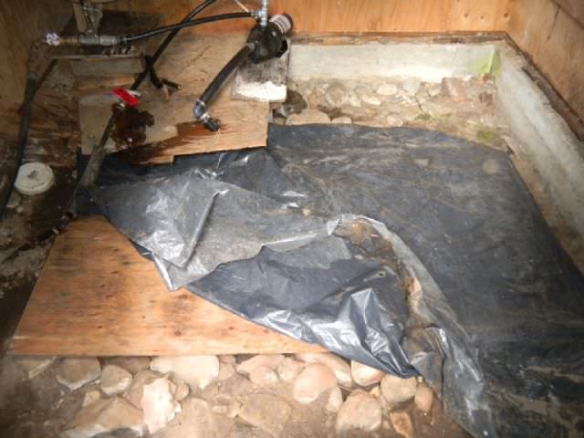

Ponyboy Posted May 21, 2010 Report Share Posted May 21, 2010 The active well on this property is a rock lined shallow well about 6-8 feet deep with a sheet of plywood over the top and then covered with plastic. I am no very familiar with wells, but know this is not a proper shallow well. What are the regulations for shallow wells? Click to Enlarge 56.56 KB A well head for a deep well was located on the other side of this property. The top of the pipe is welded shut and the metal tag on the well reads: Department Of Ecology Uniqui Well AKF912 Do not remove tag I found this tag is a well ID which led me to a Department of Ecology drilling report. This well was drilled in 2004, 61 feet, but does not look like it was ever activated. Click to Enlarge 153 KB Any other ideas? Quote Link to comment Share on other sites More sharing options...
tim5055 Posted May 21, 2010 Report Share Posted May 21, 2010 You can run the tag # you found in the State of Washington Database. From a quick read, the new well was dug in 2004 and no pump was installed. As you say it appears that it was never put in service. Quote Link to comment Share on other sites More sharing options...
Bill Kibbel Posted May 22, 2010 Report Share Posted May 22, 2010 I am no very familiar with wells, but know this is not a proper shallow well. What are the regulations for shallow wells? In PA, the standards are set by the individual county health departments. In my home county, the minimum standard requires a watertight steel casing to a minimum depth of 30' feet and 5' into bedrock or other impervious strata and grouted. This shows shallow wells are no longer acceptable. "Open surface" wells haven't been permitted since probably the first half of the last century, although I still find some occasionally in service. The most recent find was a spring-fed pond supplying all water to an inn & conference center. Quote Link to comment Share on other sites More sharing options...

Tim H Posted May 22, 2010 Report Share Posted May 22, 2010 Like Bill said, it's about local hydrogeology and regulation. Around here (Lower Alabama), the well you inspected would be a petri dish. The requirements in the counties I inspect are right in line with what Bill describes. If you want to kill a few hours learning everything you never wanted to know about private water systems, you can go here; http://www.purdue.edu/envirosoft/private/src/title.htm Quote Link to comment Share on other sites More sharing options...
