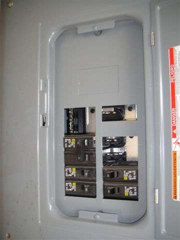

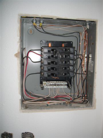

CHI Posted June 12, 2010 Report Share Posted June 12, 2010 Inspected a rehab home yesterday. 1300 sq ft split level. Walls torn out, no carpet, siding missing, no bathroom fixtures. A gas fireplace.....with no gas supplied to the home...A real gem. The home had the main panel and two sub panels. Don't know why someone felt they needed all this extra power. The main and one sub was in the garage, while the other sub was conveniently located smack dab in the dining room, nice touch. Here's what has me stumped, and maybe because of the condition of everything else in the home, I'm finding myself second guessing. The Main Panel had 6 throws to shut off everything, one of which was a 60 amp breaker to shut off the bottom half of the main panel. In that bottom half was a 70 amp breaker that fed the sub in the garage. Seems that the 70 amp is too large to be downstream from the 60 amp breaker. Mismatched breakers were noted all over the place. How many of you verify the manufacture and model number of breakers compared to the panel manufacturer? Click to Enlarge 25.86 KB Click to Enlarge 20.45 KB Click to Enlarge 38.14 KB Also the sub in the dining room is protected by a 20 amp breaker in the main panel labled...."deep freeze". This whole set up seems a bit whacked and unnessary for the size of home. There was a forced air electric furnace, heat pump, and I was informed that the home once had a exterior spa. And I would get that if the subs controlled the heat pump....which didn't work....and the spa...which wasn't there, but the subs controlled the kitchen lights, living room receptacles... Just kind of a mess. Link to comment Share on other sites More sharing options...
Jim Katen Posted June 12, 2010 Report Share Posted June 12, 2010 Inspected a rehab home yesterday. 1300 sq ft split level. Walls torn out, no carpet, siding missing, no bathroom fixtures. A gas fireplace.....with no gas supplied to the home...A real gem. The home had the main panel and two sub panels. Don't know why someone felt they needed all this extra power. The main and one sub was in the garage, while the other sub was conveniently located smack dab in the dining room, nice touch. Here's what has me stumped, and maybe because of the condition of everything else in the home, I'm finding myself second guessing. The Main Panel had 6 throws to shut off everything, one of which was a 60 amp breaker to shut off the bottom half of the main panel. In that bottom half was a 70 amp breaker that fed the sub in the garage. Seems that the 70 amp is too large to be downstream from the 60 amp breaker. You probably know this already, but that's called a split bus panel. As for the 70-amp breaker downstream of the 60-amp breaker, it's doofusy, but there's no particular rule against it other than the fact that the loads are supposed to be calculated. Mismatched breakers were noted all over the place. How many of you verify the manufacture and model number of breakers compared to the panel manufacturer? Personally, I think that's an impossible task given the mergers of companies and the presence of "classified" breakers. Also the sub in the dining room is protected by a 20 amp breaker in the main panel labled...."deep freeze". Of course, all breakers are supposed to be labeled as to their purpose. This whole set up seems a bit whacked and unnessary for the size of home. There was a forced air electric furnace, heat pump, and I was informed that the home once had a exterior spa. And I would get that if the subs controlled the heat pump....which didn't work....and the spa...which wasn't there, but the subs controlled the kitchen lights, living room receptacles... Perhaps some of the breakers should have been labeled "grow lights." - Jim Katen, Oregon Link to comment Share on other sites More sharing options...
Marc Posted June 12, 2010 Report Share Posted June 12, 2010 One issue with branch circuit or feeder breakers that are too large is that fault currents in those branch circuits might end up tripping the main breaker which then removes power from the entire dwelling. This inconveniences the homeowner. When I wire panels, I generally don't allow any branch or feeder breaker to be more than half the size of the main breaker. Marc Link to comment Share on other sites More sharing options...
