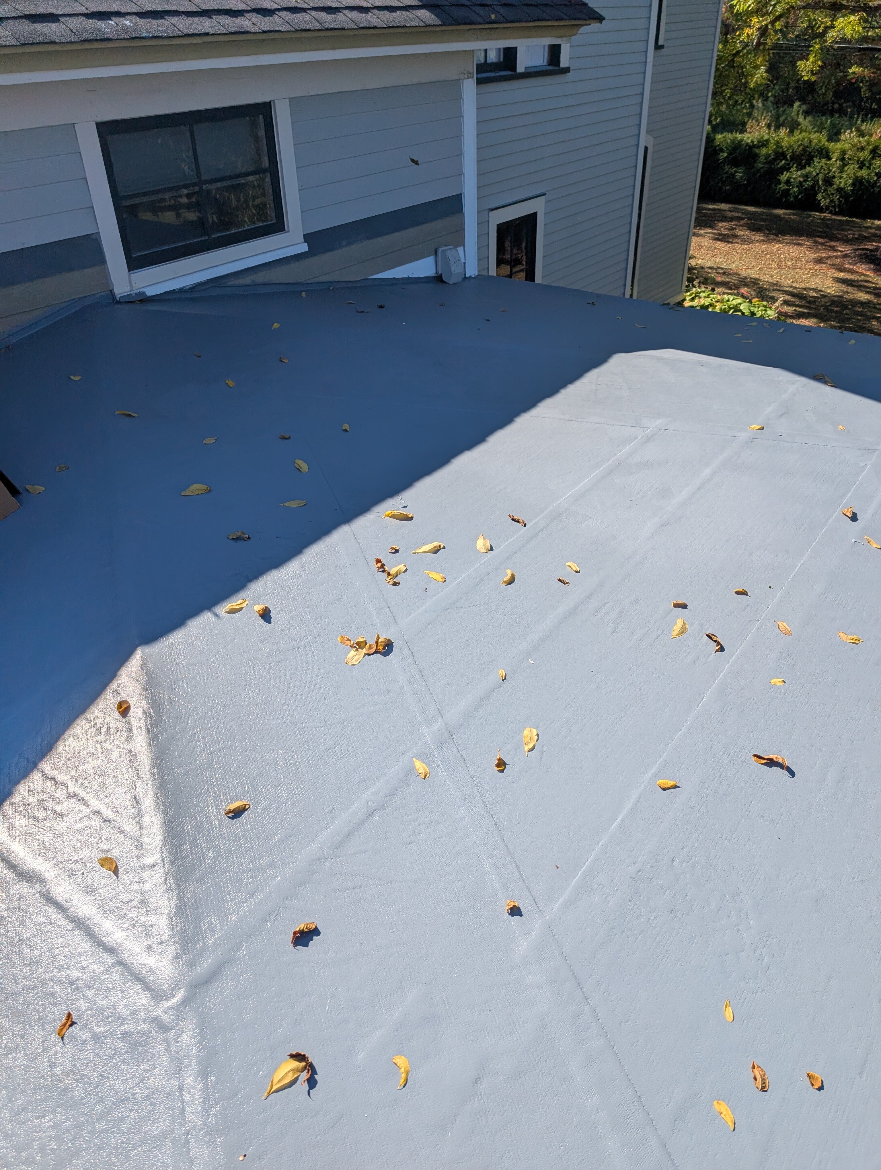

That's what they tell me. Boats and Corvettes seem to fair OK. It's recoatable, but not really easy to recoat. It requires thorough sanding followed by cleaning with acetone. (I already recoated it once becaue it was the wrong color) I figured the worst thing that can happen is it fails miserably. If that's the case, it'll make an excellent substrate for something else.
I did soldered seam terne on my balcony. It was *very* time-consuming. I considered standing seam metal, but what you can't see in the photos is a flare at the bottom of the slopes. I thought it would look cool, and it does, but you can't see it from the ground. If you visit, be sure to check out the cool flare from the upstairs bathroom window. I was afraid the standing seam would not accommodate the change of slope.
We added on to our old farmy Italianate house. It's mostly done now - I still need to add a few layers of trim and some corbels. The original house has a Medina sandstone foundation I built the addition foundation of the same material. The elevations of the addition ended up pretty close to two existing second-story windows that I didn't want to move. It left very little possibility for slope on the roof. So we built a hip roof with the lowest slope being about 1-1/2:12, and the steeper side slopes are about 2-1/2:12. There's not enough slope for any regular roofing except for products used on flat roofs. After a bit of research, I found that it's really common to use FRP(fiberglass reinforced polyester), AKA fiberglass in the UK, so I gave it a shot. Most of you know I come from an automotive background, and I'm experienced with fiberglass resins and fiberglass mats/ cloth. Still, there was a lot to learn. I learned a lot about the different resins, cloths, and appropriate weights. It was a fun diversion from peel-and-stick or modbit. The roof is two layers of 1708 cloth installed with polyester resin. It's about 220 ft. I used 14 gallons of resin. I pre-made the flashings and installed them first with fiberglass cloth and resin. Learning how much resin you can put down at a time was the most anxiety-ridden portion of the project. Once the resin and cloth were installed, I protected the assembly with two coats of gel coat—the top coat contains what's referred to as wax. The wax is a mixture of styrene and paraffin wax dissolved in acetone. You mix that into the top coat of gelcoat, and the styrene and paraffin rise to the top during the cure. They create an airproof layer that allows the gel coat to fully harden rather than remain slightly tacky. I'm fully aware of the pedantic nature of this crowd. The siding is all different colors because I had enough scraps from other jobs to fill it in.

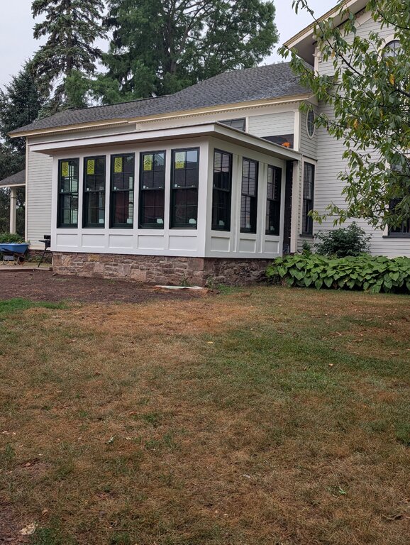

Hi Mike, It's a good thing I built it, or we couldn't afford to heat this beast. -

Thank you, everyone. The support from this group means more to me than any other. It's a great house, designed and built by others. Despite how rough it was when we bought it, it was easy to restore because all we had to do was make it the way the designer/ builder intended it to be. (to be honest, we added the balcony- prior, there was a 4'x4' personal viewing platform above the front door and below the tower windows on the adjacent side) I bought terne-coated steel for the balcony floor/roof in the late 90s for the project and didn't build it until 2016? Follansbee stopped selling terne in the US around 2010. We may be the last in the US to install a soldered seam terne roof. Kibbel helped with Tin O Lin's paint info for the project. We also deviated slightly by adding plumbing, electricity, and central heat. -
