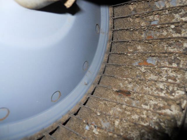

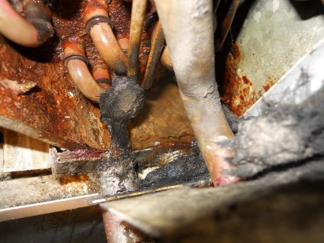

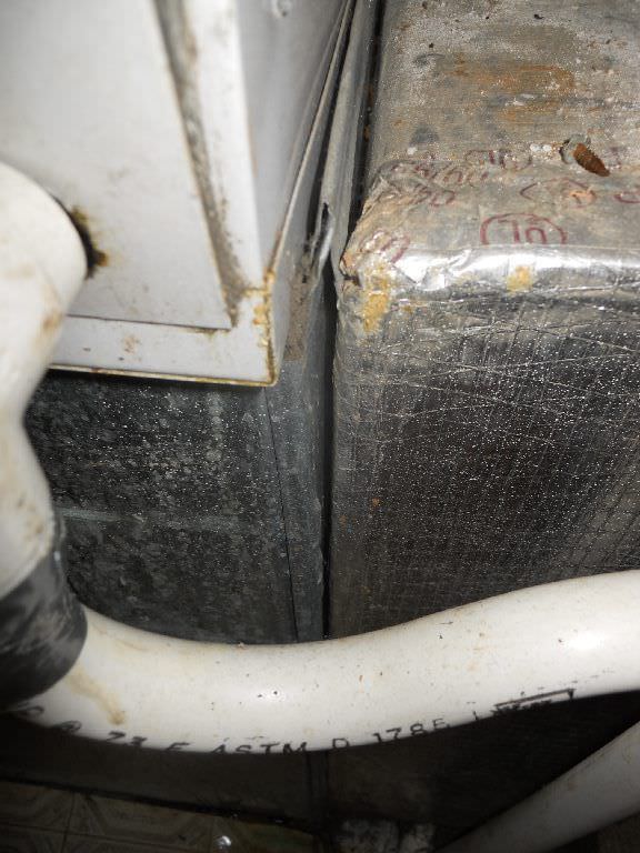

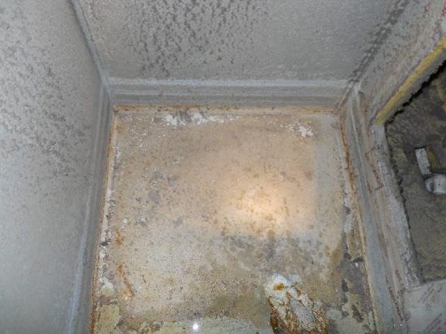

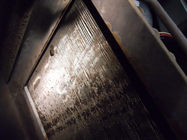

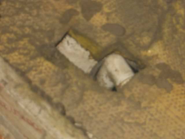

mgbinspect Posted July 31, 2010 Report Share Posted July 31, 2010 Yesterday I performed an inspecion of a vacant foreclosure home with all of the typical horrific signs of abuse and neglect. But, while making my pretty large list of what's wrong with the HVAC distribution system, (gaps, filth, contamintation, high water marks in the central return duct, Click to Enlarge 53.65 KB Click to Enlarge 48.3 KB Click to Enlarge 65.92 KB Click to Enlarge 54.1 KB Click to Enlarge 84.88 KB I ran across one condition I found particularly amusing. Someone went through the bottom of the central return duct to service the condensate drain line that drains into the floor drain that is directly under the central return duct. They didn't seal up the duct afterwards. Click to Enlarge 27.32 KB Nice! Link to comment Share on other sites More sharing options...
Marc Posted July 31, 2010 Report Share Posted July 31, 2010 There's supposed to be a gas trap below that drain opening, but if it dries out in the winter when there's no condensate flow, pheewww! Marc Link to comment Share on other sites More sharing options...
