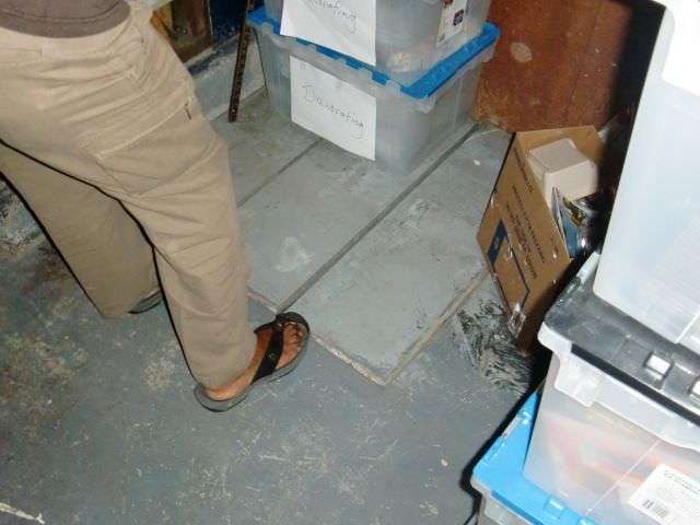

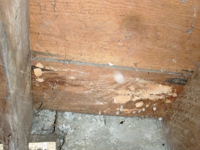

randynavarro Posted July 31, 2010 Report Share Posted July 31, 2010 I've never come across a crawl space under a basement slab. This home was built around 1910. There was "newer" concrete in the basement but so much storage I really couldn't see how well the concrete was doing. In one quadrant, the soil had been excavated and a subfloor system had been almost conventionally framed. Then concrete was poured on top of the wood frame system. The crawl space is not original to the house. The wood framing looks 1950 to 1970-ish. Here's the hatch cover. Click to Enlarge 44.87 KB Here's how the floor framing system was anchored to the adjacent concrete in the rest of the basement. Click to Enlarge 56.28 KB Here are the bugs that have chewed the wood plank flooring supporting the concrete. I'm thinking dampwood termites? Click to Enlarge 62.88 KB Anybody ever seen something like this? Why was it done? Link to comment Share on other sites More sharing options...

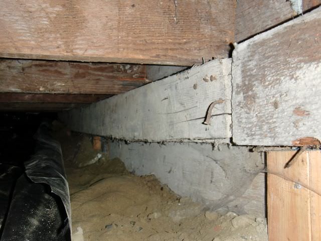

mgbinspect Posted July 31, 2010 Report Share Posted July 31, 2010 A definite first for me. Is the slab merely supported by the joists on a ledger that is cut-nailed into the concrete? That's kinda scary... Link to comment Share on other sites More sharing options...

randynavarro Posted July 31, 2010 Author Report Share Posted July 31, 2010 Note the skin color on the feet. Those feet are not pigment-challenged. My skin, however, is. Although I am of Mexican descent, I'm almost as caucasion-airy as the next guy. This inspection was for a 203(k) refinance renovation. Those feet are the homeowner's. In fact, I wouldn't have known or seen that hatch if he hadn't told me about it. Link to comment Share on other sites More sharing options...
randynavarro Posted July 31, 2010 Author Report Share Posted July 31, 2010 A definite first for me. Is the slab merely supported by the joists on a ledger that is cut-nailed into the concrete? Yes That's kinda scary... That's what I thought. However, the concrete above showed no signs of cracking or movement! Link to comment Share on other sites More sharing options...

John Kogel Posted August 1, 2010 Report Share Posted August 1, 2010 That old rough-cut wood could be older than 1950. It looks like somebody has slammed some new 2X4 support posts under the ledger. Maybe the termites had their way with the old ones. I wonder if it was originally built as a wooden floor, then covered over later with concrete? Does the site slope down from the conventional floor area to this one? That could explain the why a bit, too much fill required for a slab. Would the vents have been visible from the outside? That looks like something you would not want to miss in an inspection. You're giving me nightmares now. [] Link to comment Share on other sites More sharing options...

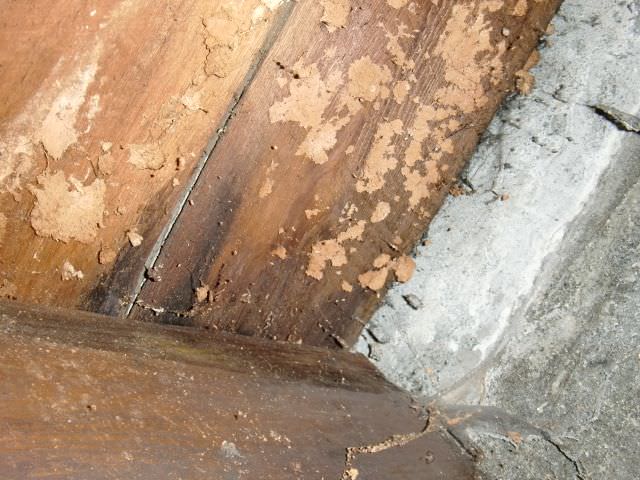

Richard Moore Posted August 1, 2010 Report Share Posted August 1, 2010 On the insect damage...my first guess would not be dampwood termites. Trouble is I don't know what type of ejected frass would cling to the underside of a board like that. Could it be the remains of an old moisture ant nest that has long since dried up and fallen off? Link to comment Share on other sites More sharing options...
randynavarro Posted August 1, 2010 Author Report Share Posted August 1, 2010 On the insect damage...my first guess would not be dampwood termites. Trouble is I don't know what type of ejected frass would cling to the underside of a board like that. Could it be the remains of an old moisture ant nest that has long since dried up and fallen off? Yes, dampwood term's was my gut. But, I agree with you, Richard, that clinging frass is interesting. I guess there's a possiblity there were some sub-termites and their tubes from soil to wood have since fallen, but I truly can't recall ever seeing a full-on soil-to-floor termite tube. Regardless, as in most finds like this, the type of insect is almost secondary. Getting all the bad wood out of there, period, is my primary recommendation. Link to comment Share on other sites More sharing options...
hausdok Posted August 1, 2010 Report Share Posted August 1, 2010 Hi Randy, Where was this home? If it's anywhere north or east of West Seattle I seriously doubt if it's subs; they don't have travelling papers and visas to come east or north of West Seattle and in 14 years here I've never found them outside of there. Did you take a piece of that stuff in your fingers and roll it and break it apart? If it was hard and breaks into tiny little mechanical pencil lead sized pellets that look like a little six-sided drum under a lupe then it is DWT frass. I used to have a little terrarium filled with PDWT, wood mulch and a chunk of rotten wood. DWT are like little brick masons. They'll move out to a part of the nest or entrance to the galleries that they want to block, turn around, eject a pellet, turn around again, smear it with saliva and then pick it up and push it up into the opening. That happens time and again until they've built a solid barrier that will keep other insects - even large carpenter ants - out. Sometimes the frass walls break loose like that and hang off the wood. ONE TEAM - ONE FIGHT!!! Mike Link to comment Share on other sites More sharing options...
Jim Katen Posted August 1, 2010 Report Share Posted August 1, 2010 The damage in the third picture wasn't caused by any kind of termite. I have a suspicion that hasn't been mentioned yet but before I make a fool of myself for suggesting it I need to know what happened to that wood when you smacked it with your pick. - Jim Katen, Oregon Link to comment Share on other sites More sharing options...

randynavarro Posted August 2, 2010 Author Report Share Posted August 2, 2010 The damage in the third picture wasn't caused by any kind of termite. I have a suspicion that hasn't been mentioned yet but before I make a fool of myself for suggesting it I need to know what happened to that wood when you smacked it with your pick. - Jim Katen, Oregon I didn't whack it for 2 reasons: 1) Clearance at this corner was only about 10". The photo was achieved by sticking my hand under a girder which was about 18" away from that corner and blocked any kind of physical access. I had to also use a bit of zoom. 2) As a 203k renovation inspection, my focus is quite different from an ordinary inspection. The goal is to simply I.D. defects and have them corrected instead of compiling informatoin for them to make an "informed" decision. I outlined two options for the borrower: a) remove and replace all inadequate and damaged wood framing (probably about 80% of what's down there) or b) rip out the framing and concrete, fill and compact with gravel and pour new concrete. Here are some more photos, Jim, if you want to take a stab at it. . . Click to Enlarge 67.32 KB Click to Enlarge 76.1 KB Click to Enlarge 90.03 KB I imagine if I probed, the wood would not necessarily crumble but easily separate. I don't suspect powdery stuff either. Link to comment Share on other sites More sharing options...
Jim Katen Posted August 2, 2010 Report Share Posted August 2, 2010 . . . Here are some more photos, Jim, if you want to take a stab at it. . . Spiders. - Jim Katen, Oregon Link to comment Share on other sites More sharing options...
randynavarro Posted August 2, 2010 Author Report Share Posted August 2, 2010 Well, that's no so whacky, Jim. I thought about spiders, but I really don't know much about them. Link to comment Share on other sites More sharing options...
