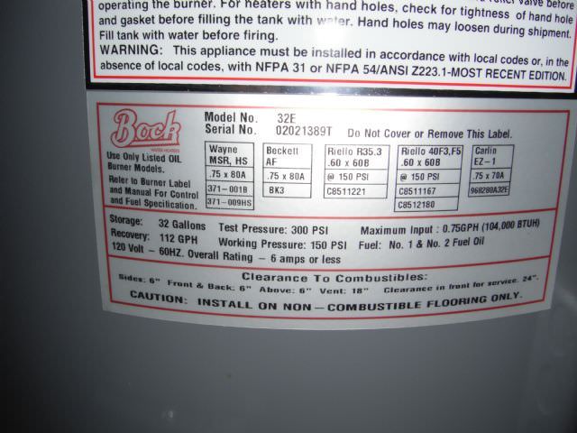

NJinspector Posted August 24, 2010 Report Share Posted August 24, 2010 Hi all, Anybody have info on how to date an oil fired Bock Water Heater? Serial# 02021389T thanks in advance Quote Link to comment Share on other sites More sharing options...
NJinspector Posted August 24, 2010 Author Report Share Posted August 24, 2010 Click to Enlarge 57.66 KB Sorry, should have included picture with first post Quote Link to comment Share on other sites More sharing options...
Jim Katen Posted August 24, 2010 Report Share Posted August 24, 2010 1st guess 2002. Confirm by looking at the date on the TPR valve. Double confirm by looking at the date on the burner. - Jim Katen, Oregon Quote Link to comment Share on other sites More sharing options...
hausdok Posted August 24, 2010 Report Share Posted August 24, 2010 Hi, Yeah, I agree with Jim; I'm thinking either the second week or the second month of 2002. ONE TEAM - ONE FIGHT!!! Mike Quote Link to comment Share on other sites More sharing options...
