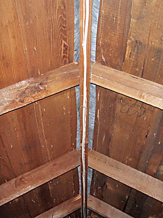

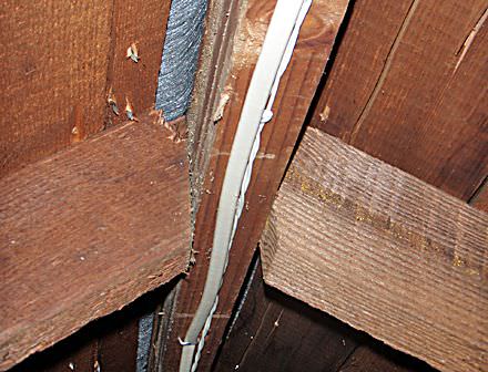

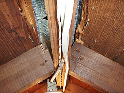

Ken Meyer Posted September 10, 2010 Report Share Posted September 10, 2010 Got a call from a homeowner this morning. He just has a new roof installed, they added ridge vents. The goof who cut the sheathing for the vents set his saw too deep and cut into every 2x4 rafter about an inch or so. Some of the rafters are now notched at the top where they meet the ridge board, which is a 2x4. The roofer is offering to repair the rafters by attaching plywood gussets on either side of each rafter. It seems like a reasonable fix to me, what do you think? Would it be better to sister some short pieces of 2x4 onto the cut rafters? Click to Enlarge 35.6 KB Click to Enlarge 39.44 KB Click to Enlarge 44.28 KB Click to Enlarge 47.74 KB Quote Link to comment Share on other sites More sharing options...

Marc Posted September 10, 2010 Report Share Posted September 10, 2010 No prescriptive method covers that, so technically an engineer is called for. Practically, I'd probably just go with the gussets. 1/2" CDX, 6 gun staples to a side. Talk to a truss manufacturer if you wish. If I detailed here what I'd do myself, we'd have a two page thread before the night was over. Marc Quote Link to comment Share on other sites More sharing options...
Marc Posted September 10, 2010 Report Share Posted September 10, 2010 I don't know. Is there a Simpson tie for that application? The only thing I could find from Simpson was the LSTA/MSTA series from the High Wind Framing Connection Guide. It's a strap that fits on top, not installed from the bottom. You'd have to removed some decking. Marc Quote Link to comment Share on other sites More sharing options...
Brandon Whitmore Posted September 10, 2010 Report Share Posted September 10, 2010 If it were my house, I'd never even fix it, based on the location of the cuts. After looking again at the pictures, the bottom edge of the rafters lack any bearing-- I'd prefer that was fixed. Quote Link to comment Share on other sites More sharing options...

Ben H Posted September 10, 2010 Report Share Posted September 10, 2010 If it were my house, I'd never even fix it, based on the location of the cuts. After looking again at the pictures, the bottom edge of the rafters lack any bearing-- I'd prefer that was fixed. I agree. If you finish the last 1/4 inch of the top cut, and look at the small ridge board, from the picture it looks like you've only got a couple of inches total support on each rafter. Quote Link to comment Share on other sites More sharing options...
Jim Baird Posted September 10, 2010 Report Share Posted September 10, 2010 Common sense tells me that adding to the ridgeboard bottom would allow the rafters to bear opposingly as they are spozed to do. That is some very aged framing isn't it? Quote Link to comment Share on other sites More sharing options...

Richard Saunders Posted September 11, 2010 Report Share Posted September 11, 2010 Or leave it as-is. They look like 2x4 rafters and will sag or break in the middle long before there is a problem at the ridge. Like Brandon alluded to, 90% of the bearing is on the lower 1/2 of those rafters. Quote Link to comment Share on other sites More sharing options...
Brandon Whitmore Posted September 11, 2010 Report Share Posted September 11, 2010 They look like 2x4 rafters and will sag or break in the middle Or split right about where the bottom of the ridge board is located. Ken, Technically, a PE is supposed to design a repair for those damaged rafters. If you get involved in telling them how to fix this, you may be overstepping in my opinion. Any chance you could e- mail the pictures to a PE in the area to see what he/ she thinks about it? The roofer is offering to repair the rafters by attaching plywood gussets on either side of each rafter. What size must the plywood gussets be? Fastened with glue, nails, and if nails, placed where? Quote Link to comment Share on other sites More sharing options...
