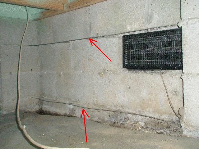

palmettoinspect Posted September 23, 2010 Report Share Posted September 23, 2010 What are these small bars in the perimeter foundation wall? House has hardcoat stucco. I imagine it has something to do with the stucco. Does anyone know? Thanks! Click to Enlarge 69.03 KB Quote Link to comment Share on other sites More sharing options...
Darren Posted September 23, 2010 Report Share Posted September 23, 2010 It looks to me like 'Dur-a-wall'. This is a 're-reinforcement' that's installed in block work. It's usually installed every other course. It's possible it's 12 inch Dur-a-wall in an 8 inch block wall. Sometimes they will do that (12 inch in an 8 inch wall with 4 inches sticking out) if you are installing a brick veneer (which obviously is not the case here). Quote Link to comment Share on other sites More sharing options...
mgbinspect Posted September 23, 2010 Report Share Posted September 23, 2010 It looks to me like 'Dur-a-wall'. This is a 're-reinforcement' that's installed in block work. It's usually installed every other course. It's possible it's 12 inch Dur-a-wall in an 8 inch block wall. Sometimes they will do that (12 inch in an 8 inch wall with 4 inches sticking out) if you are installing a brick veneer (which obviously is not the case here). Good call Darren. It does appear to be Dur-O-Wal Single Wythe Ladur. This style was not intended for brick veneer later. It appears that the masons didn't have any more eight inch reinforcement on the job so they threw in twelve inch product. Of course, it won't offer much lateral strength used like this, and if struck will merely act more like a wire reinforced pane of glass - easily pushed in, but difficult to actually push through. Quote Link to comment Share on other sites More sharing options...

palmettoinspect Posted September 23, 2010 Author Report Share Posted September 23, 2010 Thanks for the reply guys. Is it ok to use 12" vs 8"? If this stuff just adds strength for the mortar joist, I would think with the edges of the bars hanging over the sides of the concrete block wouldn't do much for strengthening the mortar. Quote Link to comment Share on other sites More sharing options...
Jim Katen Posted September 23, 2010 Report Share Posted September 23, 2010 Thanks for the reply guys. Is it ok to use 12" vs 8"? If this stuff just adds strength for the mortar joist, I would think with the edges of the bars hanging over the sides of the concrete block wouldn't do much for strengthening the mortar. No. It's a screw up done by lazy dopes. They might have just as well run a single wire through the mortar joint. Though I doubt that it'll make any difference in a little 4-course wall. Quote Link to comment Share on other sites More sharing options...
