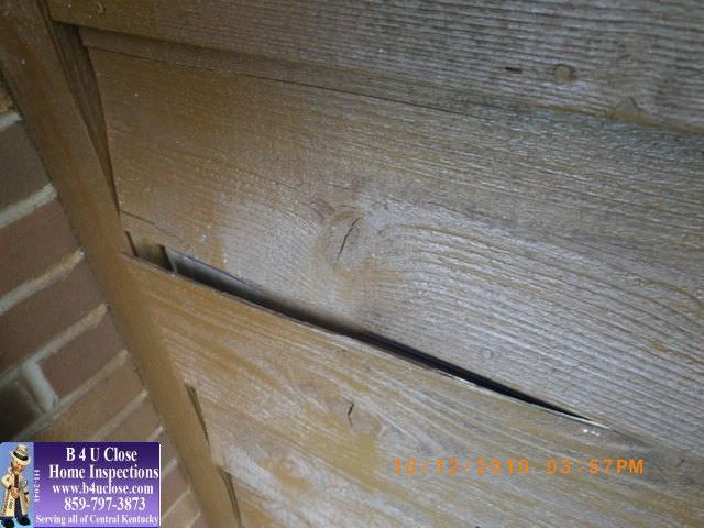

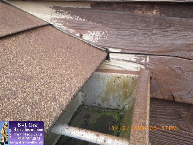

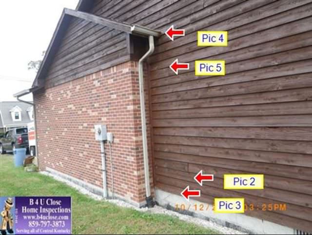

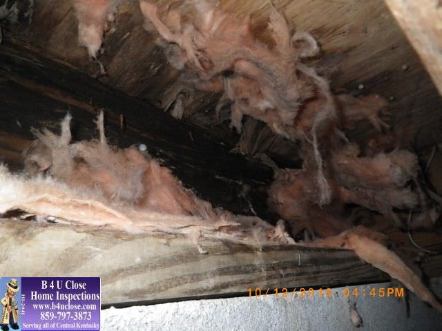

Erby Posted October 13, 2010 Report Share Posted October 13, 2010 The fun would go out of it if the new guys didn't get awhile to guess so I won't explain yet other than 16 year old house on a concrete block foundation wall w/ crawl space and wood lap siding. Seller just bought it a year ago and had his fireman buddy look at it (inspected?) for him. You can look at all six pictures all on one sheet by downloading the PDF File or one at time by clicking on them. Download Attachment: TIJPost.pdf 43.06 KB Click to Enlarge 62.87 KB Click to Enlarge 29.05 KB Click to Enlarge 49.12 KB Click to Enlarge 58.36 KB Click to Enlarge 71.25 KB Click to Enlarge 62.36 KB - Link to comment Share on other sites More sharing options...

Erby Posted October 13, 2010 Author Report Share Posted October 13, 2010 Picture 2 was behind a couple of baskets of "finer things" in the master bedroom closet. Besides, I think he was an honest seller that just didn't know any better. Said he was told the closet stuff was from a repaired plumbing leak from the sink to the right (away from the outside wall) of the closet. - Link to comment Share on other sites More sharing options...
hausdok Posted October 14, 2010 Report Share Posted October 14, 2010 Somewhere there's a roofer walking around with his head tucked firmly up his butt. ONE TEAM - ONE FIGHT!!! Mike Link to comment Share on other sites More sharing options...

Erby Posted October 31, 2010 Author Report Share Posted October 31, 2010 Buyer's respones to my follow up e-mail: ======= I think the current owners are a little angry about the thorough inspection you did. They didn't have one done and it cost them $18K. I, my loan officer and my agent think a home inspection is well worth what I paid. ======= Yeah, there were some other issues, such as the tear off and replace deck, but the above was the "big one". = Click to Enlarge 81.54 KB Link to comment Share on other sites More sharing options...
