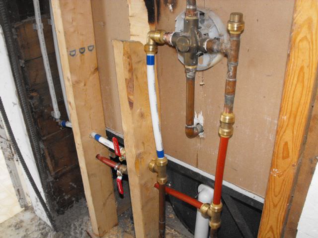

Les Posted November 2, 2010 Report Share Posted November 2, 2010 Click to Enlarge 56.61 KB Preservation company missed the pipes buried in this wall. No heat in bathroom or utility room at the left. Used to be ridgid copper, now it is more better. They will be back today to cover the two valves and reinstall the piece of paneling. Total Cost = $1200. Who caused it? = the same company that is getting over a thousand dollars from Freddie! Click to Enlarge 54.64 KB same house after furnace was cleaned and serviced. Cost $240.00, same company. This house has been thru TWO Hud inspections for financing during the past five years and is going to be picked up again by HUD for a zero down mortgage. I don't want to be political, just this sort of thing has a large negative effect on our profession. We are the bad guys! Quote Link to comment Share on other sites More sharing options...

David Meiland Posted November 2, 2010 Report Share Posted November 2, 2010 What's on the other side of the drywall? And, how often are you guys seeing those sharkbite fittings? Quote Link to comment Share on other sites More sharing options...
RobC Posted November 2, 2010 Report Share Posted November 2, 2010 If the valve is a single lever Moen valve ...then it's all wrong The valve is missing support, a 2x4 on the flat flush with the backside of the wall framing will usually work out well with 1/2" wallboard and wall tiles. This is most critical with PEX lines as they don't provide much support as copper would. The 'rough-in' template (white opaque plastic disk in front of the valve against the wallboard) should have been installed flush with the FINISHED wall. This plate is a guide in locating the valve body and protects the rough-in from construction damage, it's thrown away by the finish plumber. I'm thinking the valve is too far inside the wall for the lever to shut off the water ... Are the two lines running inside the exterior wall? Quote Link to comment Share on other sites More sharing options...
