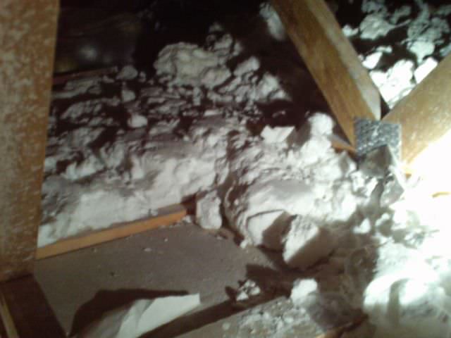

jahsun365 Posted November 20, 2010 Report Share Posted November 20, 2010 I need help identifying some attic insulation. The best way to describe it is that it looks like "snow". It is a fine white powder that is held together by some binding material in clumps until it is disturbed. Once distubed, it turns into a baking soda like powder mess and becomes airborne. It looks as if it was blown-in "wet" and was added on top of the existing fiberglass insulation that looks to be original to the house. Thanks in advance for any help. Link to comment Share on other sites More sharing options...
kurt Posted November 20, 2010 Report Share Posted November 20, 2010 How old is the house? That would tell a lot, but a picture is better. Sounds like some type of older gypsum product, which always brings in the secondary or tertiary question of "does it contain asbestos?". Often/usually not, but you never know. Link to comment Share on other sites More sharing options...
jahsun365 Posted November 20, 2010 Author Report Share Posted November 20, 2010 The home was built in 1974. This substance may have been a retrofit, there is evidence of fiberglass insulation under it in some areas. Click to Enlarge 42.45 KBa Link to comment Share on other sites More sharing options...
Jim Katen Posted November 20, 2010 Report Share Posted November 20, 2010 The home was built in 1974. This substance may have been a retrofit, there is evidence of fiberglass insulation under it in some areas. Click to Enlarge 42.45 KBa That's UFFI. - Jim Katen, Oregon Link to comment Share on other sites More sharing options...
Bill Kibbel Posted November 20, 2010 Report Share Posted November 20, 2010 Jim is correct but brief. UFFI - Universal Foreign Function Interface? More specifically it's Urea Formaldehyde Foam Insulation. If you Google it, don't freak out over what you might read. Formaldehyde out-gassing has ceased long ago. Link to comment Share on other sites More sharing options...

kurt Posted November 20, 2010 Report Share Posted November 20, 2010 A misapplied UFFI installation. Blowing it over fiberglass........nice........[:-censore Link to comment Share on other sites More sharing options...
