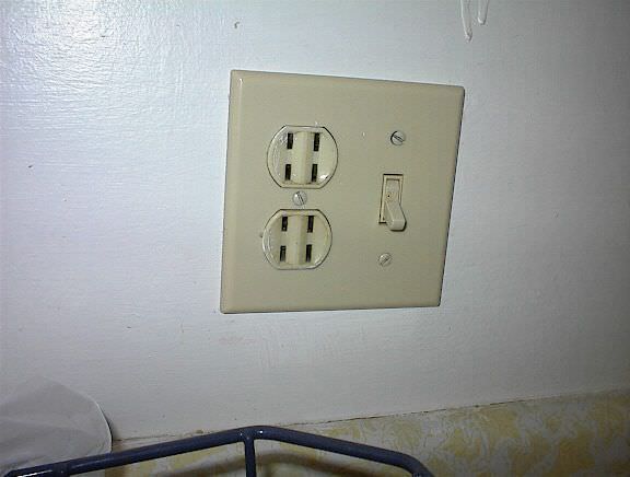

JeremyDP Posted November 27, 2010 Report Share Posted November 27, 2010 Here's an odd plug from an inspection earlier today. I have not had any luck with my internet searches. Probably due to my lack of knowledge on how to describe it. Can anyone tell me about it? Thanks! Click to Enlarge 3.07 KB Link to comment Share on other sites More sharing options...
John Kogel Posted November 27, 2010 Report Share Posted November 27, 2010 If it's in a 50's or older house, it might simply be four places to plug 2-prong cords in. People in those days found ingenious ways to get more out of that one outlet in the room. Link to comment Share on other sites More sharing options...
JeremyDP Posted November 27, 2010 Author Report Share Posted November 27, 2010 Thanks! The house was built in December of 1959. That is what I was thinking, but didn't want to go with an assumption. I should also mention that the home was winterized, so I was not able to test it. And the paint sealed the face plates to the walls. Link to comment Share on other sites More sharing options...

JeremyDP Posted November 27, 2010 Author Report Share Posted November 27, 2010 Thanks Jim! Would these be called Quadruple Outlets? And they are ungrounded, right? Link to comment Share on other sites More sharing options...

Jim Katen Posted November 27, 2010 Report Share Posted November 27, 2010 Thanks Jim! Would these be called Quadruple Outlets? And they are ungrounded, right? I don't know what they're called. Quads is as good as anything, I guess. Yes, they're ungrounded. - Jim Katen, Oregon Link to comment Share on other sites More sharing options...
Bill Kibbel Posted November 27, 2010 Report Share Posted November 27, 2010 I don't know what they're called. Quads is as good as anything, I guess. "4-way" woohoo! They're not unusual here - from late 40s to about the mid 60s. Link to comment Share on other sites More sharing options...

Charlie R Posted November 29, 2010 Report Share Posted November 29, 2010 Not necessarily "ungrounded" although there is obviously no place for the "ground" prong of a three prong receptacle. If the receptacle is attached (installed in) to a metal box and wired with armored cable back to the main service panel, which should be grounded, then you may have grounding there. Link to comment Share on other sites More sharing options...
