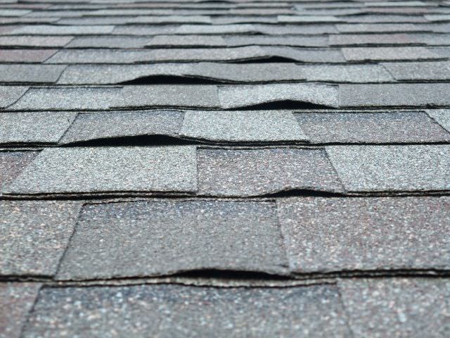

Marc Posted March 26, 2011 Report Share Posted March 26, 2011 New construction. 12/12 pitch roof. What could have caused this delamination? They occurred only midway across the width of the shingle, not on either side. Not the whole roof, just in a couple large areas. Occasional bad bundle? Consequences of allowing them to remain in place? Click to Enlarge 88.31 KB Marc Quote Link to comment Share on other sites More sharing options...
Jerry Simon Posted March 26, 2011 Report Share Posted March 26, 2011 New construction. 12/12 pitch roof. What could have caused this delamination? They occurred only midway across the width of the shingle, not on either side. Not the whole roof, just in a couple large areas. Occasional bad bundle? Consequences of allowing them to remain in place? Click to Enlarge 88.31 KB Marc Those sure look like proud nails. Quote Link to comment Share on other sites More sharing options...
Jim Katen Posted March 26, 2011 Report Share Posted March 26, 2011 Poor storage of the bundle. Someone set the bundle on a 2x4 or something similar and the shingles took a set. What you're seeing isn't delamination, but distortion in the shingle that never settled down. Put a dime-size daub of mastic under each of those spots then set a brick on each one. They'll settle down and never be a problem. If you leave them like this, wind-blown rain will go between the shingles, rust out the fasteners and might cause trouble. Wind might also grab them. - Jim Katen, Oregon Quote Link to comment Share on other sites More sharing options...
Jim Katen Posted March 26, 2011 Report Share Posted March 26, 2011 Those sure look like proud nails. Or that. Quote Link to comment Share on other sites More sharing options...
Marc Posted March 26, 2011 Author Report Share Posted March 26, 2011 Thanks fellas. Jim, that reminds me - Roofers here usually pile bundles over the ridge and leave them there overnight before installing in the mornings. That woulda caused them deformities in the shingles. Beautiful[:-thumbu]. Marc Click to Enlarge 51.83 KB Quote Link to comment Share on other sites More sharing options...

Marc Posted March 27, 2011 Author Report Share Posted March 27, 2011 Nails working up/out? Usually due to insufficient ventilation..? Just an idea.. No. The laminated shingles were separated between the layers. Lower layer remained flat on the roof. I've written it up. Fix it. This here's a hurricane prone area, 110 mph wind zone. I also mentioned that the manufacturer's warranty might be voided on account of this. Plenty enough reason to fix it. Sometimes I feel like a fisherman, the bigger they are, the more there are, the better. It translates my fees into service. Marc Quote Link to comment Share on other sites More sharing options...
kurt Posted March 27, 2011 Report Share Posted March 27, 2011 I thought proud nails, but the more I think about it, the poor storage solution makes the most sense. Quote Link to comment Share on other sites More sharing options...
Brandon Whitmore Posted March 28, 2011 Report Share Posted March 28, 2011 I'm a little late to the game, but agree that it looks like a storage issue vs. a nail issue on this one. Quote Link to comment Share on other sites More sharing options...
Marc Posted March 28, 2011 Author Report Share Posted March 28, 2011 Here's the write up: Many shingles exhibit a condition usually caused by allowing bundles of shingles to sit on the ridge of the roof for too long prior to installing them on the roof surface. This condition will increase the vulnerability of the shingle to hurricane force winds, leading to early failure and may void the manufacturer's warranty. 6) Replace any distorted shingles. Marc Quote Link to comment Share on other sites More sharing options...
