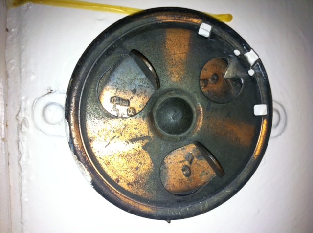

Jim Morrison Posted May 18, 2011 Report Share Posted May 18, 2011 I snapped a photo of this roughly 2 1/2 inch diameter thing nailed thigh-high into the side of an interior stair stringer in a circa 1880's house because: 1) I thought it was about time I posted a photo here, and I figured if anyone would know what it might be, it would be our Mighty Mr. Kibbel. The photo isn't great, but even putting your nose right up to it in person didn't offer a clearer view. Thoughts? Quote Link to comment Share on other sites More sharing options...

Jim Morrison Posted May 18, 2011 Author Report Share Posted May 18, 2011 Buncha wise-asses.... I'll try it again. I'll also add that there were no wires attached to it, and I couldn't see where there ever might have been wires attached to it. Download Attachment: Thing.JPG 122.77 KB Quote Link to comment Share on other sites More sharing options...
Terence McCann Posted May 18, 2011 Report Share Posted May 18, 2011 Looks like a shudder adjustment off a burner doesn't it? Be interested to see what BK has to say. Quote Link to comment Share on other sites More sharing options...
Robert Jones Posted May 18, 2011 Report Share Posted May 18, 2011 That does look like it was some kind of vent closure thingy. Quote Link to comment Share on other sites More sharing options...
Terence McCann Posted May 18, 2011 Report Share Posted May 18, 2011 All of the shudder adjustments I've seen though rotate. From the placement of the thumb tabs it can not rotate, only move up or down (assuming the tabs are attached to the inner piece of metal). Gas lighting perhaps? I really should stop farting around here and get back to my report. [8] Quote Link to comment Share on other sites More sharing options...
Jim Morrison Posted May 18, 2011 Author Report Share Posted May 18, 2011 Terry, It did rotate, but only a little. The original coal fired furnace was located in the basement and this was on the first floor. It's a dome-scratcher, J Quote Link to comment Share on other sites More sharing options...

Bain Posted May 18, 2011 Report Share Posted May 18, 2011 To me, it looks like the thumb tabs are on the outer piece of metal, so one can align the pointer with . . . something. I have less restraint than Jimmy, and no doubt would have rotated the thing to see what the letters on the inner piece of metal said. And yes, I probably would have broken it. Quote Link to comment Share on other sites More sharing options...

mgbinspect Posted May 18, 2011 Report Share Posted May 18, 2011 Whatever it is, here are some clues: 1. It's incomplete - the soot staining suggests there was some form of cover. 2. There appears to be solder spots on the back plate - possibly to bond the back? Quote Link to comment Share on other sites More sharing options...
Jim Morrison Posted May 19, 2011 Author Report Share Posted May 19, 2011 The nasty yellow is runoff from an amateurish refinishing of the stairs. Ignore it. And the impulse to suggest it somehow came from me. Like Sr. Bain, I was tempted to move the interior dial and I did, but it didn't move much. The interior dial was movable about 25 degrees or so to the left or right, possibly less, but not more. Quote Link to comment Share on other sites More sharing options...
Bill Kibbel Posted May 19, 2011 Report Share Posted May 19, 2011 The home was built just shortly before the "automatic regulator" (thermostat) was invented to control coal furnace dampers. The dial turns the center shaft that goes back into the wall cavity. There is an arm or sprocket on the shaft that raised and lowered a pair of chains simultaneously. The chains operated the draft and check-draft dampers of the furnace. The words that become visible in the openings of the dial will include "open" and "closed". Below the wall of that stairwell, the holes where the chains entered the basement are likely visible. Quote Link to comment Share on other sites More sharing options...
Bill Kibbel Posted May 19, 2011 Report Share Posted May 19, 2011 I checked just a couple publications and didn't find a diagram of that exact device. I did find this description in Mechanics of the Household, 1918: "As a means of changing the dampers of the furnace from the floor above, to suit the prevailing conditions, the arrangement does away with the necessity of a journey to the basement, to remedy each change of temperature". We should write like that in our reports! Quote Link to comment Share on other sites More sharing options...

mgbinspect Posted May 19, 2011 Report Share Posted May 19, 2011 Cool! (an android phone never does these photos justice). So, the two silver tabs limit travel? Quote Link to comment Share on other sites More sharing options...
