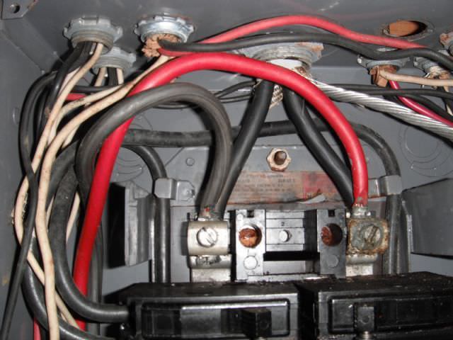

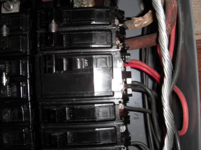

NJinspector Posted June 14, 2011 Report Share Posted June 14, 2011 At a recent re-inspection I was surprised to see that this panel had been unchanged. Then the owner handed me a receipt from a licensed electrician stating that this panel is safe per the NEC. Am I missing something? Click to Enlarge 59.28 KB Click to Enlarge 45.04 KB Quote Link to comment Share on other sites More sharing options...

Jim Port Posted June 14, 2011 Report Share Posted June 14, 2011 Those lugs are for ONE conductor. This is improper. Quote Link to comment Share on other sites More sharing options...
hausdok Posted June 14, 2011 Report Share Posted June 14, 2011 Find out who licenses electricians in your state. If they have an electricians board staffed by a group of electricians, send them a copy of the photo along with a copy of the letter from the electrician and ask them to profer an opinion. Bet they'll drop the hammer. ONE TEAM - ONE FIGHT!!! Mike Quote Link to comment Share on other sites More sharing options...
ghentjr Posted June 14, 2011 Report Share Posted June 14, 2011 At a recent re-inspection I was surprised to see that this panel had been unchanged. Then the owner handed me a receipt from a licensed electrician stating that this panel is safe per the NEC. And, you said. . . . . . .? Quote Link to comment Share on other sites More sharing options...
NJinspector Posted June 14, 2011 Author Report Share Posted June 14, 2011 I asked the owner if the electrician even opened up the panel. He said "Yup, stared at it for quite some time and couldn't find anything wrong". I then proceeded to show him what was wrong and advised that him that he should find another electrician. Quote Link to comment Share on other sites More sharing options...
