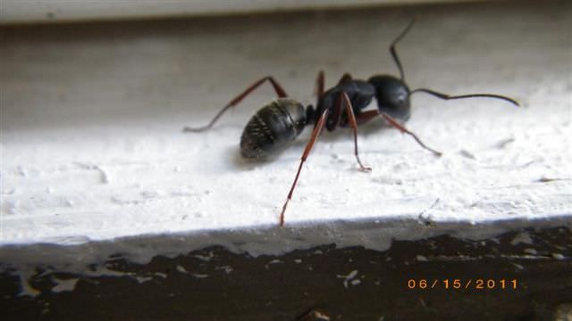

Robert Jones Posted June 15, 2011 Author Report Share Posted June 15, 2011 Found this pic of Modoc, touched it up a bit and thought I would post. Pretty cool. Click to Enlarge 55.75 KB Quote Link to comment Share on other sites More sharing options...
Tom Raymond Posted June 15, 2011 Report Share Posted June 15, 2011 Great pic! I'm very tempted to snag him for my wallpaper. Quote Link to comment Share on other sites More sharing options...

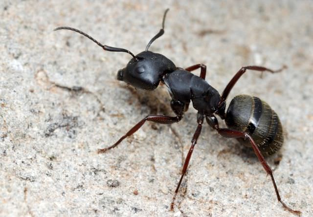

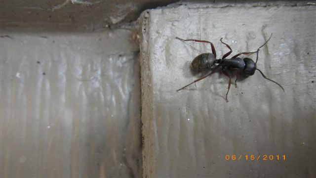

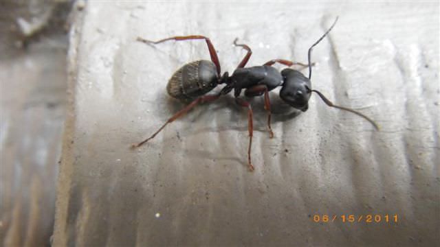

Robert Jones Posted June 15, 2011 Author Report Share Posted June 15, 2011 Ok last post on this. Found these modoc's at my home inspection this afternoon. The Pentax worked well. Some really good detail, although not as good as the regular size photo. Click to Enlarge 26.78 KB Click to Enlarge 29.06 KB Click to Enlarge 27.43 KB Quote Link to comment Share on other sites More sharing options...
hausdok Posted June 16, 2011 Report Share Posted June 16, 2011 Good shots, Rob The second photo shows all three required characteristics very clearly. OT - OF!!! M. Quote Link to comment Share on other sites More sharing options...
kurt Posted June 16, 2011 Report Share Posted June 16, 2011 Yep, good shot. I put it in my graphics library. Quote Link to comment Share on other sites More sharing options...

Jim Katen Posted August 1, 2011 Report Share Posted August 1, 2011 Great pic! I'm very tempted to snag him for my wallpaper. Her. Quote Link to comment Share on other sites More sharing options...
