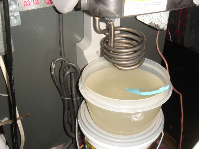

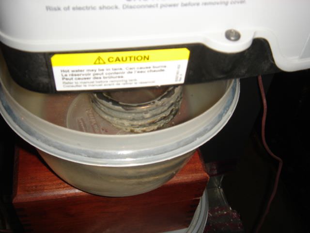

Bain Posted January 2, 2012 Report Share Posted January 2, 2012 Today is the first truly cold day this winter, so I decided to fire up my humidifier, a Honeywell TruSteam. Almost predictably, the error lights illuminated and the thing refused to operate. There was scale in all the water ports, and the heating element was nearly completely coated with gunk. The instructions say to use a scouring pad to clean the element, but that's nearly impossible due to the small grooves, especially since the element can't be removed. My solution? Fill a plastic tub with vinegar and let the thing soak. Does anyone have a better idea, though? The humidifier is only two years old, and the filter was replaced last season, so it's not as if there's years and years of neglect to contend with. Click to Enlarge 32.12 KB Link to comment Share on other sites More sharing options...

Bain Posted January 2, 2012 Author Report Share Posted January 2, 2012 Well, but the vinegar actually did the trick, and the humidifier is working like it's supposed to. Interestingly, this is only the second occasion I'm aware of in which Jim Katen was wrong. The other occasion was when he told me I had a bright future ahead of me and would no doubt be a tremendous success. Click to Enlarge 43.25 KB Link to comment Share on other sites More sharing options...

hausdok Posted January 3, 2012 Report Share Posted January 3, 2012 Yeah, Vinegar is acidic as hell. I use it all the time to descale the coffee machine. ONE TEAM - ONE FIGHT!!! Mike Link to comment Share on other sites More sharing options...

allseason Posted January 3, 2012 Report Share Posted January 3, 2012 The water in my town is really hard. Cheap white vinegar works very well for the coffee maker and the stainless steel interior of the dishwasher. You need to let it sit a while, or work it a bit with a soft toothbrush. Good and cheap. Link to comment Share on other sites More sharing options...
HVACMASTER Posted March 15, 2012 Report Share Posted March 15, 2012 Get reverse osmosis filter for the steam or get rid of it. We have a 5x5 box full of removed tru steams at the warehouse. Juice aint worth the squeeze Link to comment Share on other sites More sharing options...
