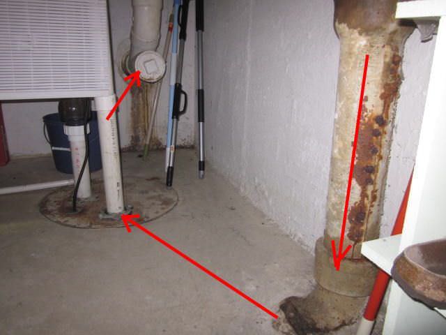

Mike Lamb Posted January 27, 2012 Report Share Posted January 27, 2012 It is standard fare in the split-level homes I inspect to have a bathroom drain its waste into the sewage pit of the adjacent lower level even though it could easily get routed into the main sewer and drain via gravity which would seem the better option. Since I see this all the time there must be a good reason but I don?t know what it is. Click to Enlarge 42.33 KB Quote Link to comment Share on other sites More sharing options...
Bill Kibbel Posted January 27, 2012 Report Share Posted January 27, 2012 I can't think of any logical reason. How old is that house? Split-level era seems kinda young for complete cast iron pipe failure. Quote Link to comment Share on other sites More sharing options...
Chad Fabry Posted January 27, 2012 Report Share Posted January 27, 2012 Union pump? Quote Link to comment Share on other sites More sharing options...
emalernee Posted January 27, 2012 Report Share Posted January 27, 2012 I have not seen that setup in Splits in my area (Northeast Ohio). Quote Link to comment Share on other sites More sharing options...
kurt Posted January 27, 2012 Report Share Posted January 27, 2012 Sewer backup. Before Deep Tunnel, that lower level bathroom would be a geyser of poop. Now, not so much. Quote Link to comment Share on other sites More sharing options...
Mike Lamb Posted January 27, 2012 Author Report Share Posted January 27, 2012 I have seen this set-up many times like I said. I thought there must be a reason. Around here the split level style was mostly a 70s thing. The DWV was all plastic except at this location. The cast iron failure has to be because it was lousy stuff. The listing on this home was 1988. Quote Link to comment Share on other sites More sharing options...
Mike Lamb Posted January 27, 2012 Author Report Share Posted January 27, 2012 Sewer backup. Before Deep Tunnel, that lower level bathroom would be a geyser of poop. Now, not so much. Thanks. That makes some sense. The bathroom level is below grade. Quote Link to comment Share on other sites More sharing options...
