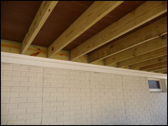

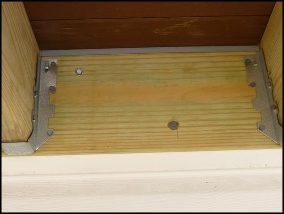

John Dirks Jr Posted February 4, 2012 Report Share Posted February 4, 2012 This is the first time I've seen fasteners this small. They look like ones I saw in a JLC article. However, in the article they were not using them for a deck attachment. Even then, they should have washers I believe. There are two fasteners per bay all the way across. I'm not sure of their shear strength and they sure look like they could use washers to prevent from pulling through. The last attachment is a ThruLok bulletin but I dont know if these are ThruLok screws on this deck. Anyway, you can see in the bulletin that they should have washers on the outer side. Have you seen these before? Is this a suitable deck attachment? Download Attachment: P1220584.JPG 82.51 KB Download Attachment: P1220585.JPG 74.53 KB Download Attachment: P1220586.JPG 85.99 KB Download Attachment: P1220574.JPG 100.8 KB Download Attachment: thrulok-sell-sheet.pdf 440.96 KB Link to comment Share on other sites More sharing options...
John Dirks Jr Posted February 4, 2012 Author Report Share Posted February 4, 2012 Wait...I found this http://www.mcfeelys.com/product/HLL-143 ... HLL-1435-L And this.... http://www.fastenmaster.com/details/pro ... g_1211.pdf So I conclude they are legit. Link to comment Share on other sites More sharing options...
hausdok Posted February 4, 2012 Report Share Posted February 4, 2012 Yeah, There are about half a dozen various screws designed and rated for ledger to house attachment now. Most of them are self-drilling types and I guess it's up to the screw manufacturer whether or not they're supposed to have washers. Absent instructions from the screw manufacturer, you're kind of screwed. I'd probably recommend the buyer find out who built the deck, then contact the contractor to find out who made the screws and then use that information to determine if they'd been installed in accordance with the manufacturer's specs. ONE TEAM - ONE FIGHT!!! Mike Link to comment Share on other sites More sharing options...
Garet Posted February 4, 2012 Report Share Posted February 4, 2012 Could it be this... http://www.strongtie.com/products/connectors/SDS.asp They indicate it's approved for ledger attachment. Link to comment Share on other sites More sharing options...
Bill Kibbel Posted February 4, 2012 Report Share Posted February 4, 2012 Simpson clearly marks the heads, so it's easy to identify if they're correct for the application. I can't read what's on the heads in the OP's pics. Link to comment Share on other sites More sharing options...
rkenney Posted February 4, 2012 Report Share Posted February 4, 2012 Every County in Maryland that I'm aware of requires 1/2" bolts. They each have their own permit, inspection procedure (footing, framing, finish, etc.). Link to comment Share on other sites More sharing options...
Chad Fabry Posted February 4, 2012 Report Share Posted February 4, 2012 Every County in Maryland that I'm aware of requires 1/2" bolts. They each have their own permit, inspection procedure (footing, framing, finish, etc.). It's the prescriptive method, but the AHJ would be hard pressed to explain why he or she would not accept a listed, labeled and rated alternative. Link to comment Share on other sites More sharing options...
Garet Posted February 4, 2012 Report Share Posted February 4, 2012 Simpson clearly marks the heads, so it's easy to identify if they're correct for the application. I can't read what's on the heads in the OP's pics. Yes, they're marked. But I wouldn't agree with the clearly part. I've had a hard time seeing the marking when holding one loose in my hands. It's hard to put much of a marking on such a tiny surface. Link to comment Share on other sites More sharing options...

Charlie R Posted February 7, 2012 Report Share Posted February 7, 2012 Download the Baltimore County deck specs, they state "House band board - use minimum 1/2" carriage stagger bolted 16" or minimum 2 Ledger Locks 16" on center." I think the rest of the Maryland counties are the same but they haven't updated their on-line specs to say that yet. I know I've seen it in Carroll and Anne Arundel. Link to comment Share on other sites More sharing options...

Charlie R Posted February 8, 2012 Report Share Posted February 8, 2012 Checked in for the latest on a couple of other counties in Maryland (Howard & Carroll) and their specs for ledger attachment say "For other approved attachment such as LedgerLok: Fastener shall be 7? oc staggered up to 12? joist span, 5? oc over 12?." I believe your picture indicates the need for more fasteners. Link to comment Share on other sites More sharing options...
