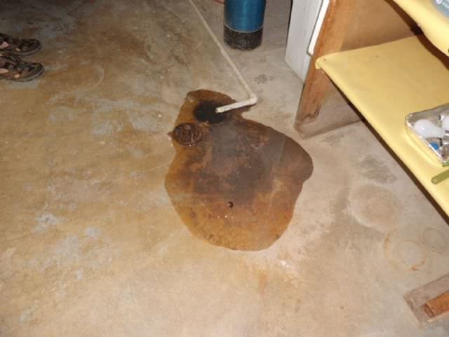

asihi Posted March 21, 2012 Report Share Posted March 21, 2012 Don't evaluate washers and dryers. They are nice-to-have accessory options and aren't part of the house. Look at the plumbing connected to them, look at the receptacles, look at drains, but leave the danged machine alone. If the buyer or the spouse wants to test it they know just as much as you do about testing it. You can't teach 'em anything about it that they don't already know so let 'em go for it on their own. If they break it they buy it. ONE TEAM - ONE FIGHT!!! Mike I can't agree with this. I had one a while back where the washing machine drained into on old concrete utility tub. The tub drained fine when I ran the water at the faucet, but when the washing machine drained, water flowed out of the floor drain in the basement. Apparently the drain line under the slab collapsed and had to be torn out and replaced. I would have never found this if I didn't run the washing machine. Click to Enlarge 40.77 KB Quote Link to comment Share on other sites More sharing options...
Robert E Lee Posted March 21, 2012 Report Share Posted March 21, 2012 Don't evaluate washers and dryers. They are nice-to-have accessory options and aren't part of the house. Look at the plumbing connected to them, look at the receptacles, look at drains, but leave the danged machine alone. If the buyer or the spouse wants to test it they know just as much as you do about testing it. You can't teach 'em anything about it that they don't already know so let 'em go for it on their own. If they break it they buy it. ONE TEAM - ONE FIGHT!!! Mike I can't agree with this. I had one a while back where the washing machine drained into on old concrete utility tub. The tub drained fine when I ran the water at the faucet, but when the washing machine drained, water flowed out of the floor drain in the basement. Apparently the drain line under the slab collapsed and had to be torn out and replaced. I would have never found this if I didn't run the washing machine. Click to Enlarge 40.77?KB I'm on the testing side of the debate, I've found several restricted/broken drain lines that only show up when a large volume (full tub) of water hits the drain lines. Quote Link to comment Share on other sites More sharing options...
Tom Raymond Posted March 21, 2012 Report Share Posted March 21, 2012 The multitude of stains on the floor wouldn't have alerted you to the frequent back ups? I don't operate any appliances unless my client specifically asks me to. The rig in the OP is under a grand brand new today, and it's 7 years old. It will require several hundred dollars in parts by the time it's 10 (ask me how I know this). If they can't afford to fix or replace it maybe they should be considering less house. Quote Link to comment Share on other sites More sharing options...
asihi Posted March 21, 2012 Report Share Posted March 21, 2012 The multitude of stains on the floor wouldn't have alerted you to the frequent back ups? No. I like getting clear evidence. There would be no way for me to determine if the stains were old or even what caused them. Quote Link to comment Share on other sites More sharing options...
kurt Posted March 21, 2012 Report Share Posted March 21, 2012 I would love it if appliances could simply be excluded completely, but folks expect me to test them. So, I "test" them. I turn everything on during my first "scouting" run around the house. Everything is running while I'm doing the job. It takes about 1 minute to hit a few buttons. Every once in a while, something leaks, or doesn't work. Those are phone calls I won't be getting. Not complicated, not technically exhaustive, but operating stuff can show me other stuff I'd not have found otherwise. Quote Link to comment Share on other sites More sharing options...
