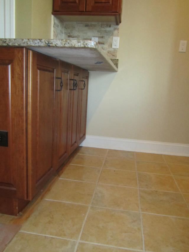

allseason Posted June 28, 2012 Report Share Posted June 28, 2012 Recent inspection, one of the granite countertops on a peninsula is mounted on a 12" cabinet box and has a 12" overhang. I commonly recommend support/brackets under these but there are doors under the overhang, making the choice one or the other, doors or brackets. My worst case scenario is that people will sometimes sit on the counters. General consensus please. Click to Enlarge 50.6 KB Quote Link to comment Share on other sites More sharing options...
Bill Kibbel Posted June 28, 2012 Report Share Posted June 28, 2012 10" max overhang for 1.25" countertop of granite or marble. I would probably tell the folks just what you typed here. Quote Link to comment Share on other sites More sharing options...
David Meiland Posted June 28, 2012 Report Share Posted June 28, 2012 Bill, where'd you get that number from? Quote Link to comment Share on other sites More sharing options...
Bill Kibbel Posted June 28, 2012 Report Share Posted June 28, 2012 Bill, where'd you get that number from? It was posted here about 5 years ago. It's originally from the Marble Institute of America's MIA Dimension Stone Design Manual. Quote Link to comment Share on other sites More sharing options...
allseason Posted June 28, 2012 Author Report Share Posted June 28, 2012 Thanks Bill. Quote Link to comment Share on other sites More sharing options...
tim5055 Posted June 28, 2012 Report Share Posted June 28, 2012 I just had a similar countertop made. Multiple granite companies in the Norther Virginia area stated they would not go over 9" without placing a flat steel sheet between the granite and the top of the box for support. No quoted source from any of them, but they were all giving the exact same answer. Quote Link to comment Share on other sites More sharing options...
