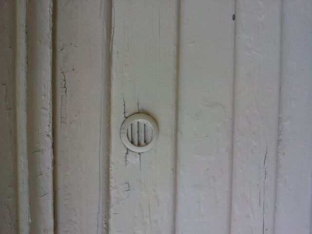

leeboy Posted August 1, 2012 Report Share Posted August 1, 2012 Click to Enlarge 26.06 KB Quote Link to comment Share on other sites More sharing options...
John Kogel Posted August 1, 2012 Report Share Posted August 1, 2012 It is a plug in the wood siding of an old house which is laying on its side. [] Often there will be rows of plugs, indicating that insulation was blown into the walls. Quote Link to comment Share on other sites More sharing options...
Chad Fabry Posted August 1, 2012 Report Share Posted August 1, 2012 It's a vent. Quote Link to comment Share on other sites More sharing options...
Steven Hockstein Posted August 1, 2012 Report Share Posted August 1, 2012 I assume you were you holding the camera sideways? The vent "Top" is not on top of your photo. Quote Link to comment Share on other sites More sharing options...
kurt Posted August 1, 2012 Report Share Posted August 1, 2012 We call them vent plugs. Like Kogel said, it usually means there's blown in insulation; very common with blown in cellulose. Quote Link to comment Share on other sites More sharing options...
Bill Kibbel Posted August 1, 2012 Report Share Posted August 1, 2012 Around here, there mostly used for venting moisture out of wall cavities, where paint perpetually blisters on the wood siding. Quote Link to comment Share on other sites More sharing options...
BryanDaum Posted September 6, 2012 Report Share Posted September 6, 2012 And they are often painted closed like screened vents. Bryan Quote Link to comment Share on other sites More sharing options...
