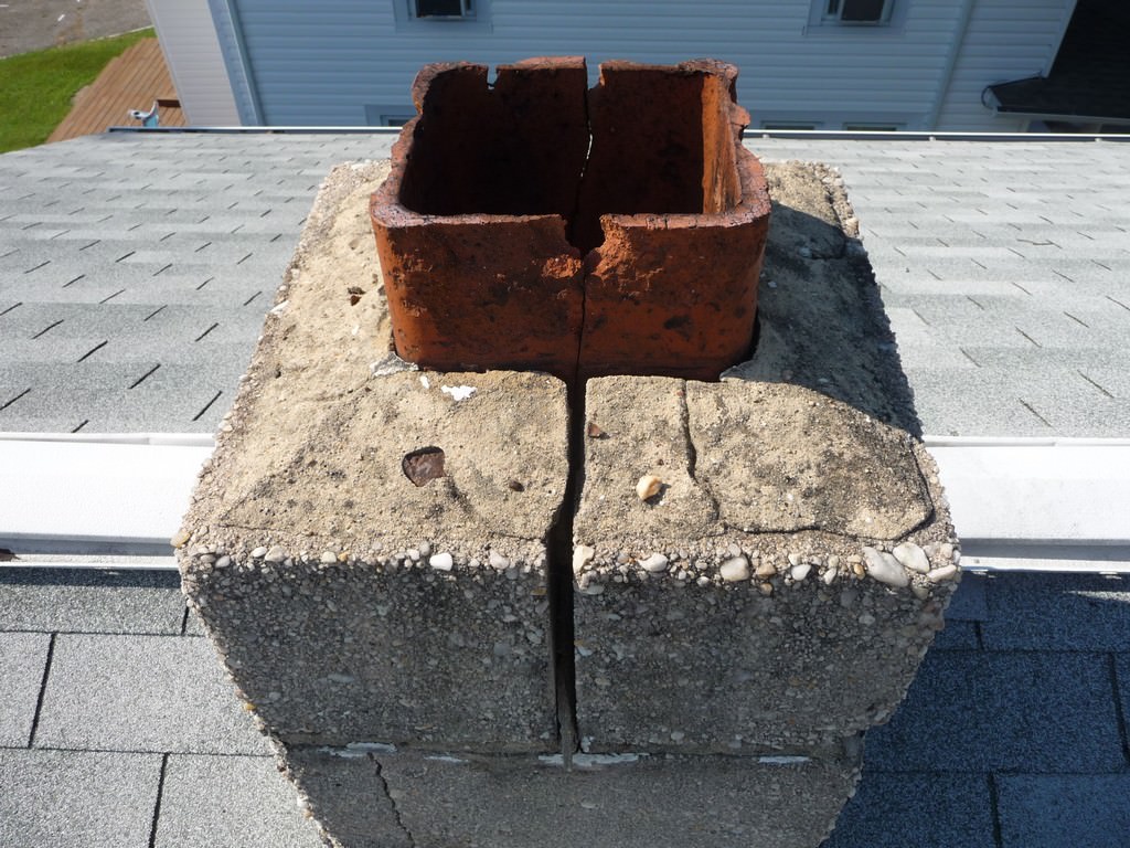

John Dirks Jr Posted August 31, 2012 Report Share Posted August 31, 2012 I'm aware that code allows mixing venting of gas and oil appliances in the same flue. However, could the combination be contributing to the deteriorated condition shown in the picture? Oil fired hydronic boiler and gas fired WH in same flu. Download Attachment: P1290243.JPG 280.68 KB Quote Link to comment Share on other sites More sharing options...
hausdok Posted August 31, 2012 Report Share Posted August 31, 2012 That flue is likely oversized and has been causing flue gases to condense on its sides for decades. Being acidic, those gases trash the clay liner. Of course, the gas burns at a lower temperature so those gases will cool sooner. Also, if it's a gas appliance with a 24/7 pilot those gases from the pilot will be condensing all the time. It happens with both oil and gas flues so I wouldn't peg it to just mixing the two so much as I would to an oversized flue. ONE TEAM - ONE FIGHT!!! Mike Quote Link to comment Share on other sites More sharing options...
Bill Kibbel Posted August 31, 2012 Report Share Posted August 31, 2012 Yes. Mixing oil and gas fired appliances in the same clay-lined flue causes deterioration much sooner than same-fuel equipment. Also, changing from oil to gas equipment and utilizing the same flue results in rapid deterioration of the clay liner as well. The condensate from the gas appliance, combined with the sulfur deposits from oil-fired equipment results in rather aggressive sulfuric acid. I always encourage relining with both the above. It'll need it sooner rather than later. As Mike stated, the flue dimension is often oversized for the updated equipment anyway. Quote Link to comment Share on other sites More sharing options...
John Dirks Jr Posted September 2, 2012 Author Report Share Posted September 2, 2012 It's getting assaulted from above too. Download Attachment: P1290241.JPG 303.45 KB Quote Link to comment Share on other sites More sharing options...
Mark P Posted September 2, 2012 Report Share Posted September 2, 2012 It's getting assaulted from above too. Download Attachment: P1290241.JPG 303.45?KB Good Grief! Quote Link to comment Share on other sites More sharing options...
