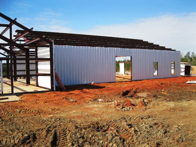

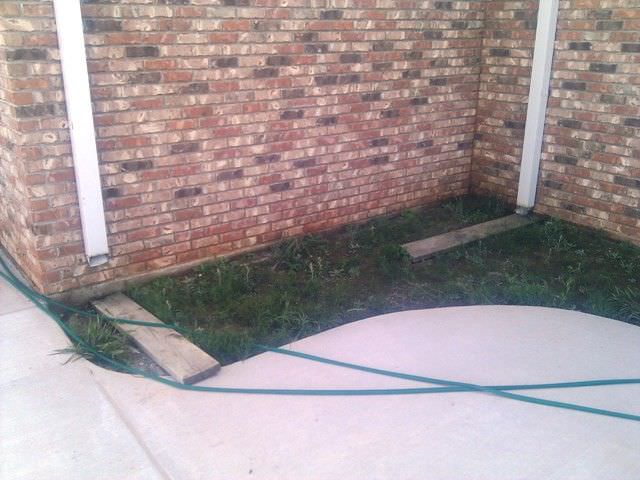

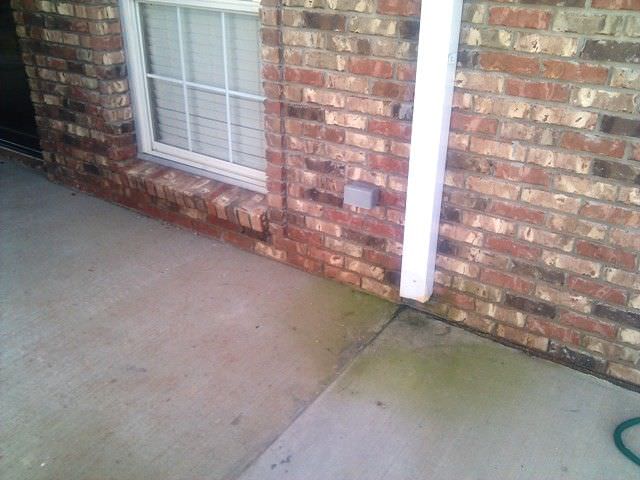

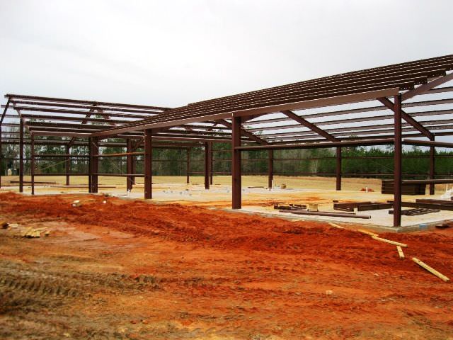

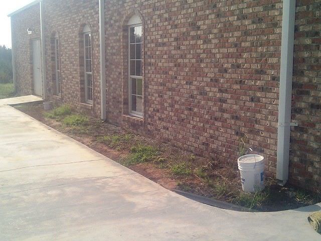

squidbilly Posted September 3, 2012 Author Report Share Posted September 3, 2012 Pictures of church building Red Iron Click to Enlarge 70.05 KB Metal Siding Click to Enlarge 82.08 KB east side with downspouts and brick veneer Click to Enlarge 65.58 KB downspout close to front entrance Click to Enlarge 60.58 KB south side of building Click to Enlarge 68.47 KB Quote Link to comment Share on other sites More sharing options...

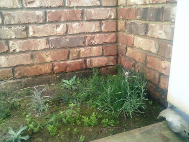

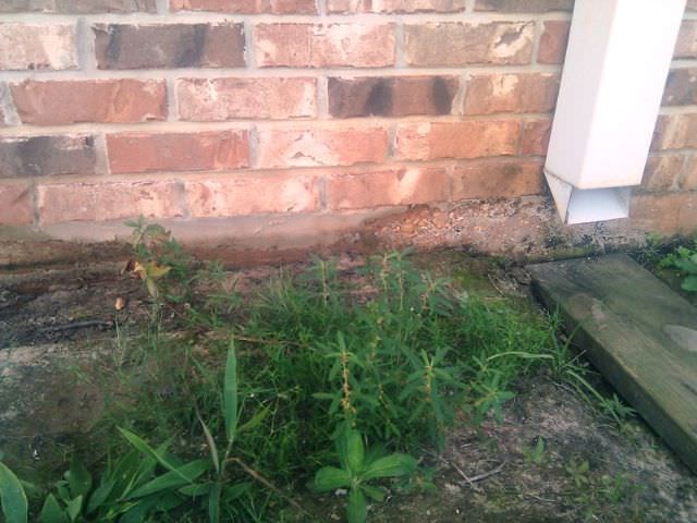

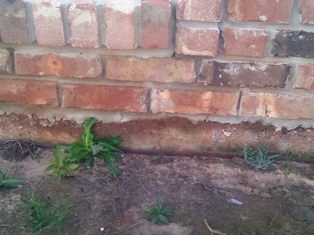

squidbilly Posted September 3, 2012 Author Report Share Posted September 3, 2012 More Pictures. notice mortar patched beneath bottom brick layer close to downspout Click to Enlarge 63.36 KB bottom brick layer Click to Enlarge 71.87 KB wet corner Click to Enlarge 65.38 KB broad view of east side of the building Click to Enlarge 35.69 KB Quote Link to comment Share on other sites More sharing options...
Marc Posted September 3, 2012 Report Share Posted September 3, 2012 Looks like the foundation/floor system was poured much too low. The soil and adjacent slabs for driveways, etc are much too close to the lowest course of brick. There should be at least 4" of foundation exposed to keep ground water from seeping in, rotting the floor finish and allowing mold growth. Without exposed foundation, termites can get in unseen. You should install a rainwater drainage system to carry water from all downspouts to the municipal rainwater drain opening or ditch. If your gutter/downspout system is too small and overflows during conditions of heavy/protracted rainfall, you might need some measures taken there also such as additional downspouts or a continuous rainwater drain system throughout the perimeter of the building. None of this is guaranteed to solve the problems that are a consequence of a foundation/floor that's too low to the ground. Marc Quote Link to comment Share on other sites More sharing options...
charlieb Posted September 4, 2012 Report Share Posted September 4, 2012 Any photos of the metal siding installation in progress? Have you checked the condition of the gutters and downspouts. This is a common source of water infiltration in building of this design. At what rate was the rain hitting your area during the storm? Quote Link to comment Share on other sites More sharing options...
squidbilly Posted September 4, 2012 Author Report Share Posted September 4, 2012 Any photos of the metal siding installation in progress? Have you checked the condition of the gutters and downspouts. This is a common source of water infiltration in building of this design. At what rate was the rain hitting your area during the storm? Hi and thanks for your response. Unfortunately, I do not have any pictures of the metal siding actually being installed ..... just the typical before and after pictures. We actually have not checked the gutters and downspouts yet, but I am fairly certain the rainfall rate (approx. 3"-4"/hr, perhaps greater) was enough to overwhelm them given the slow movement of the hurricane. Now, we are obviously finding it difficult to test various failure points given our inability to reproduce those extreme wind/rainfall conditions. Quote Link to comment Share on other sites More sharing options...
inspector57 Posted September 5, 2012 Report Share Posted September 5, 2012 I would be looking for WRB (water repellant barrier) under or over the sheet metal behind the brick. As part of that system there should be flashing installed shingle style behind and under the brick. The lack of weep holes won't likely cause water entry but will help to retain water inside the wall to make things deteriorate. DON'T let them try to drill to add weeps! That would just damage any flashing that might be present. They might CAREFULLY remove a brick every few feet to inspect for flashing then put the brick back while making provision for the weep. I'm with Marc though, the foundation is too close to the ground and it will be near impossible to make that building leak proof. Quote Link to comment Share on other sites More sharing options...
kurt Posted September 6, 2012 Report Share Posted September 6, 2012 Yes, sited too "low", grade too high, no flashing (ouch), gutters and spouts dumping water into brick. It's made to leak. Sorry to have to say it. Ouch...... I'd bet there's combinations of problems, (not just one problem) in some areas. At least, that's how it looks in the pics. Quote Link to comment Share on other sites More sharing options...

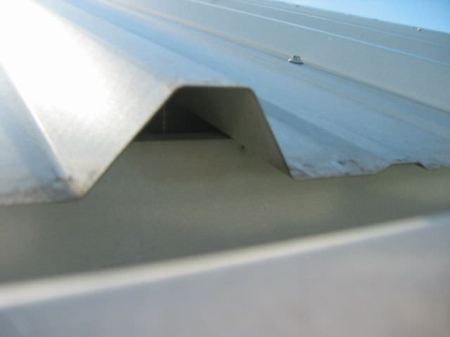

squidbilly Posted September 10, 2012 Author Report Share Posted September 10, 2012 Thanks for the responses. I have included a few more pictures of the gutter system. I think a lot of water is getting behind the veneer from the top (refer to 2nd picture) since there is no flashing or closure strips up there. Do the gutters look alright otherwise? As it stands, I feel like we need to remove the veneer and start over, but their is simply no funds to do that at this time ..... unless we borrow. Click to Enlarge 37.02?KB Click to Enlarge 19.58?KB Quote Link to comment Share on other sites More sharing options...
Marc Posted September 10, 2012 Report Share Posted September 10, 2012 That's a little more overhang than I would've done. Gutter/downspout is often done wrong but this one looks alright. I'm assuming there's some eaves flashing in there. Beneath the underlayment, over the gutter. Can't make it out in the 2nd photo. Marc Quote Link to comment Share on other sites More sharing options...
squidbilly Posted September 10, 2012 Author Report Share Posted September 10, 2012 That's a little more overhang than I would've done. Gutter/downspout is often done wrong but this one looks alright. I'm assuming there's some eaves flashing in there. Beneath the underlayment, over the gutter. Can't make it out in the 2nd photo. Marc No, there isn't. If water gets under that ridge in the metal roofing (shown in 2nd picture), there nothing to prevent it from getting behind the veneer, no flashing or closure strips. Thus, I was wondering is it would be possible to perhaps retrofit some type of flashing between the top of the brick veneer wall and the bottom of the metal roofing to make that space watertight and prevent water from getting behind the brick veneer wall? Quote Link to comment Share on other sites More sharing options...
Phillip Posted September 10, 2012 Report Share Posted September 10, 2012 [quote No, there isn't. If water gets under that ridge in the metal roofing (shown in 2nd picture), there nothing to prevent it from getting behind the veneer, no flashing or closure strips. Thus, I was wondering is it would be possible to perhaps retrofit some type of flashing between the top of the brick veneer wall and the bottom of the metal roofing to make that space watertight and prevent water from getting behind the brick veneer wall? It is possible to retrofit flashing for the areas you want to cover. The bad part is that you may have to remove the gutters and take the bottom row of screws out of the roof panels to install it. The easiest thing you could do is to install some metal drip flashing that runs over the back side of the gutter and under the roof, then install the roam closure that made to seal off the ribs of the roof panels. Quote Link to comment Share on other sites More sharing options...
Tom Raymond Posted September 10, 2012 Report Share Posted September 10, 2012 I don't think the roof details are your problem but I'd go ahead and install the closure strips anyway. What do the windows and doors look like? Most of the time I see them caulked to the J channels without any other flashing or pans. If none of the penetrations are detailed correctly at the steel the building will leak like a sieve regardless of the veneer details. Quote Link to comment Share on other sites More sharing options...
Marc Posted September 10, 2012 Report Share Posted September 10, 2012 I agree with Phillip. With the panels overhanging that far into the gutter, you may have to remove the gutter to install the eaves flashing, AKA drip edge. And yes, you've got to have eaves flashing beneath the panels, above the underlayment and over the gutter. The only cornice on this building is the gutter, so Isaac is right, an overflow at the back of the gutter could end up behind the brickwork. Installing that eaves flashing isn't a terrible lot of expense or time. Just pull out the metal-panel screws on the lowest deck board and slide your flashing in there. BTW, ridge is defined as the top of the roof. The bottom of the roof surfaces on a hip roof is known as the eaves. Someone needs to report Bubba. He's struck again. Marc Quote Link to comment Share on other sites More sharing options...
