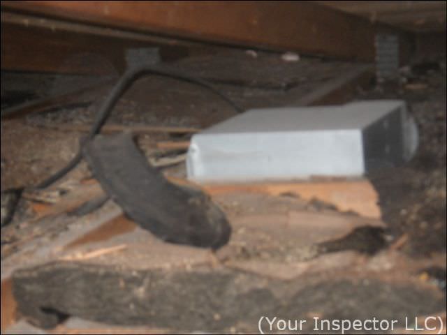

John Kogel Posted October 8, 2012 Report Share Posted October 8, 2012 This home was built in 1970, just before manufactured trusses became the standard. I think the ridge is about 4' above the ceiling joists and the rafter ties cut the space in half. I took a half dozen pics from the hatch, including the area and a plumbing vent above the bathroom, and moved on. Got to the bathroom and saw a ceiling fan. There was no sign of a vent stack in the attic. The metal pipe I did see is all the way in the kitchen. Checked the kitchen, yep there's the metal pipe going into the attic. The soffits are all stuccoed over except for a couple of vent holes at the ends. So I spread my sheet over the clothes in the closet again and pulled out the ladder and opened the hatch again. Then I hurdled over 8 of the rafter ties and got this great picture of a 40 year old dust plume. Click to Enlarge 55.64?KB Click to Enlarge 56.95?KB Click to Enlarge 61.06?KB Click to Enlarge 68.62?KB Quote Link to comment Share on other sites More sharing options...

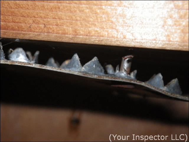

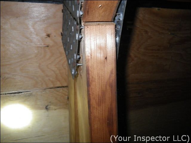

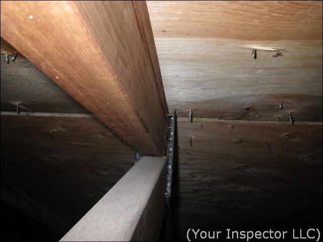

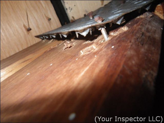

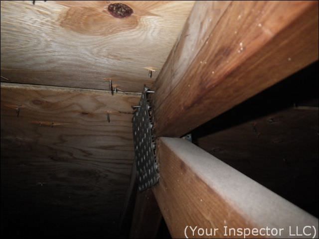

hausdok Posted October 8, 2012 Report Share Posted October 8, 2012 Yeah, Hauled my butt through one of those the other day. The roof had a 10-degree pitch (2.18:12 slope) - trusses. 10 year old deck. It was about 18-inches from the ceiling joists to the underside of the top chord at the apex. Ridge vent and eave vents and two gable end vents. Bath fans venting into the attic space. Pieces of fungi-covered delaminated plywood everywhere that had been left over from the previous roof deck. Every single gusset plate I saw was separated from it's truss. Someone had made a feeble attempt to nail the gusset plates back and they apparently didn't know how to swing a hammer 'cuz the nails weren't even driven in all the way. I could actually jiggle the diagonal webs with my hand. Incipient rot in the truss chords. They look fine but the cell structure was no longer capable of gripping those pressed-in gusset plates. The roofer who put the new deck on a decade ago thought he had the solution by putting a ridge vent on but he was too dim-witted to figure out that if the plywood deck was completely rotted that the rot had probably travelled into the trusses; and he obviously had no idea that venting fans into an attic and leaving gable end vents open when there are ridge vents was about as dumb as he was. They'd remodeled the home and converted one of four upstairs bedrooms into the large bath for the master bedroom suite. Guess where the attic hatch is? It used to be in a closet in that fourth bedroom - now it's in the ceiling of the, wait for it......shower. Entered 8ft. from the north gable end wall and hauled my ample butt over twenty of those bottom chords on my stomach to get all the way to the other end. Couldn't roll completely over to take these photos. Had a little board, 6-inches wide by about 26 inches long that I hauled along with me and would rest on top of it before moving on to the next truss. Like a chubby inch worm - took probably 20 to 30 minutes in oppressive heat. I (we) don't get paid enough for this s***. Click to Enlarge 36.36?KB Click to Enlarge 37.75?KB Click to Enlarge 32.03?KB Click to Enlarge 31.58?KB Click to Enlarge 37.82 KB Click to Enlarge 39.56?KB Click to Enlarge 40.96?KB ONE TEAM - ONE FIGHT!!! Mike Quote Link to comment Share on other sites More sharing options...

Marc Posted October 8, 2012 Report Share Posted October 8, 2012 The white residue identifies the incipient rot? So if I stab it with a screwdriver, it'll give? Just looking for a reliable way to identify it. I've seen it many time in crawls here but never knew it was a fungus based decay. Marc Quote Link to comment Share on other sites More sharing options...

hausdok Posted October 8, 2012 Report Share Posted October 8, 2012 The white residue identifies the incipient rot? So if I stab it with a screwdriver, it'll give? Just looking for a reliable way to identify it. I've seen it many time in crawls here but never knew it was a fungus based decay. Marc Nah, that's just some surface fungi of some sort. The incipient rot is in the wood. Take an ice pick, insert it perpedicular to the grain and snap it sideways. If the wood breaks out as a long sliver it's OK if it breaks off clean across the grain there's rot there. John, that house was built in 1963. Guess trusses debuted a little earlier around here. ONE TEAM - ONE FIGHT!!! Mike Quote Link to comment Share on other sites More sharing options...
